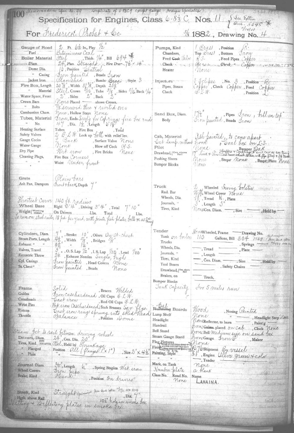

 Post subject: Re: NG Plantation Engines Returned to Maui
PostPosted: Thu Dec 08, 2011 3:47 pm
Posts: 489
BLW SPECIFICATION

M. Austin - Thank you so much for sharing the BLW build page for #6397.
This thing has kinda snow-balled on me. I started looking for information about one locomotive and have since discovered that my G-G-Grandfather had purchased 5 from the Baldwin Locomotive Works and 3 from the Danforth Locomotive & Machine Co.
It appears that they were all shipped to the Sandwich Islands where he built a railroad of some type. From what I can gather they were used for moving sugar cane.
I've ordered a book that I located on line that describes his shipping the locomotives and constructing a railroad on a plantation. Hopefully it will shed some more light on him and the engines.
The 3 Danforth Locomotives were purchased in 1875 and their numbers were, 1014, 1015 and 1016. If anyone happens to have any information on them I'd appreciate hearing about it.
Thank you,
Fred

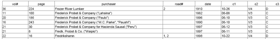

PostPosted: Fri Dec 09, 2011 12:12 am
Posts: 489
HERE IS THE F. PROBST INDEX LIST FROM DeGOYLER

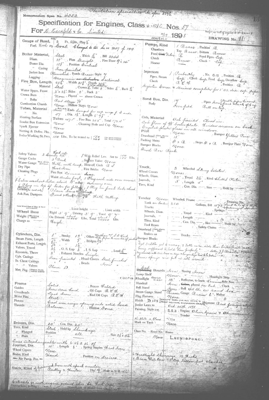

PostPosted: Fri Dec 09, 2011 12:54 am
Posts: 489
LAUNIOPOKO-BLW SPECIFICATION
PostPosted: Fri Dec 09, 2011 12:46 pm
Joined: Wed Nov 30, 2011 12:25 am
Posts: 6
M. Austin - Thanks again, for posting the F. Probst index list from DeGoyler. I have downloaded the index and engine information from their site.
Too bad that type of information is not available for Danforth locomotives, or maybe it is and I just haven't found it.
Thanks again,
Fred
