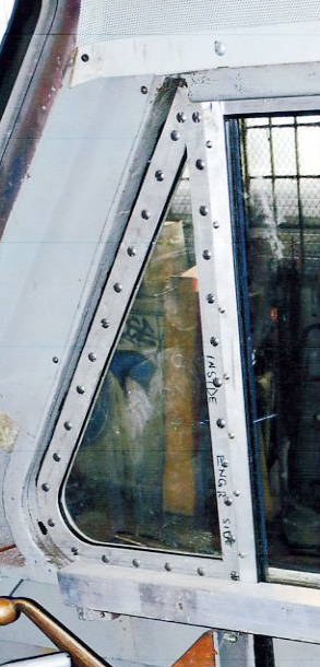

This photo appeared on the NKP190 website recently and shows the small trim window for an Alco cab unit. I've talked to Doyle McCormack a bit and he said they purchased the proper glass and made up the frame for it. In comparing notes with Doyle it turns out that the PA and FA shared the same windshields and side windows. He is quite busy right now and couldn't supply additional information or drawings on what he had made so I drew up a cross-section of what I think will work. The FRA type 2 glass is 3/8" thick. I have searched the internet for aluminum extrusion with a cross section that will work and have found none so I am thinking of having it milled from a piece of aluminum bar stock. The FA I am working on is a former LI cab car which had the original windows gutted and sliding "bus" windows attached to the outside. I think all ex LI cab car had this done so what I am trying to replace is applicable to the other ex LI units or may have already been done? Looking for ideas and suggestions....
Rich Jahn
File comment: Fixed "vent" window showing inner clamp ring holding 3/8" FRA glass

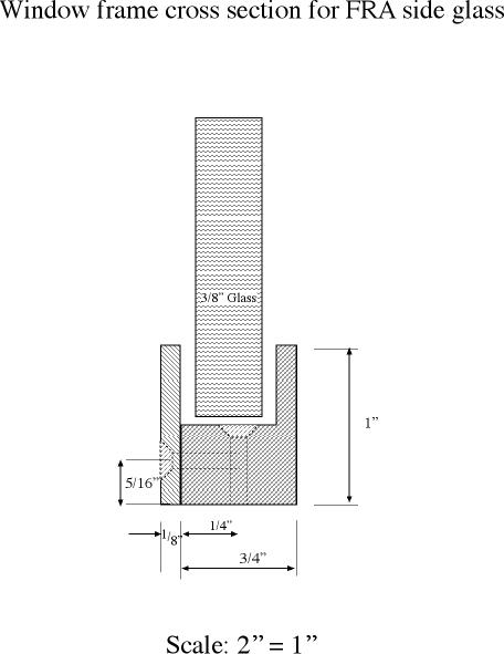

File comment: possible cross-section to be made

I do not think you have a bad solution. Have you a source for what must also be a custom rubber gasket to seat and seal the glazing?

I have it planned for a "U" shape rubber gasket.There are several companies offering various profiles. Google search - rubber extrusions. There are also companies which will make custom profiles if you want at least 500 ft.

Understand about the glass regs and the cost but my main issue is I have a big empty hole with plywood over it where some representation of side cab glass should be. I have no existing sash. I need to make some kind of frame to hold some type of glazing material so the opening can be sealed from outside weather. Doyle McCormack has sucessfully purchased glazing material that meets type 2 regulations. Dynamic Metals now has these parts in their system and thus those of us with similar locomotives can purchase this glass. At about $150 per piece it is not cheap but it is not that huge of an expenditure either.
Whatever is to hold the glass is my major concern right now. One metal company that I talked to that works with aluminum extrusions could not bend what I need since their min radius is 4.5 inches, I need about 3.5 inch for the "vent" window curve.

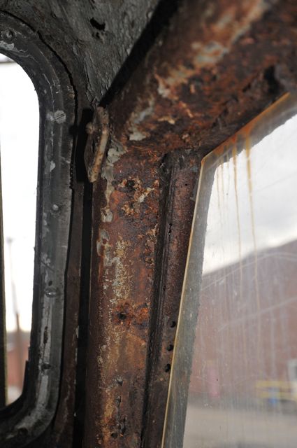

To clarify a bit more I've attached a photo of what is existing. Raw opening - no sash - nothing existing. Thus the question about suggestions on how to make window frames / sash without costing a fortune. FRA glass is about $150.00 per piece but if Dynamic Metals is to make a custom frame that will be well into four figures. By comparison gasket and size / type of glass is the easy part.
The photo shows an existing piece of acrylic just sitting in the rusty opening with no type of seal. This is the situation that needs to be improved

Looking at the drawing cross section, how about making it in three pieces, and screwing or welding it together?
Have the three parts cut on a waterjet and size the thickness of the middle section to fit a off the shelf gasket.
-Hudson

I've used flat rubber tape about an inch wide as a gasket by simply wrapping it around the edge of the glass before shoving it into the channel. If there's a lot of extra room to fill, cork tape is readily available as pipe insulation and is sticky on one side, and can be cut and stuck to the glass and capped with caulk at the edge open to the weather.

If you could use something which is only 9/16" thick instead of 5/8" (or maybe adjust the design of the frame to do so), RPM Mechanical might stock it.
Check their Item # XU-0375-01
I've never dealt with them, found this thru Thomas Net.
