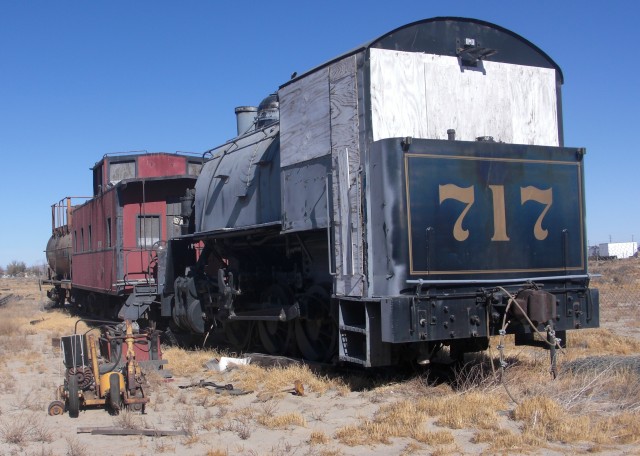

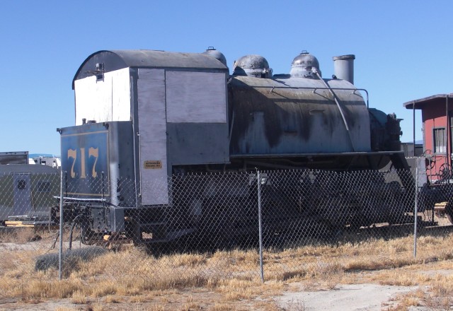

I finally found the time on one of my semi-annual inspection trips up to the Trona to stop in Lancaster and look for this engine. Found it exactly where it was described above. If I did this right, here are two images of it where it sits today.
Greg

This is, in fact the Porter loco from Bluegrass RR Museum that I have referenced earlier in this thread.
We did load the loco in Orrville with one of the steam cranes, not diesel, in 1989. I don't remember what the heritage of that crane is, but can find out if somebody REALLY wants to know. I have video.
The ASME "L" stamp was used on a Locomotive type boiler, and was section III of the ASME boiler code. With the demise of steam locomotives, ASME section III is now the "Nuclear Code", and any modern locomotive boilers are built with the standard ASME "S" (high pressure) stamp.
