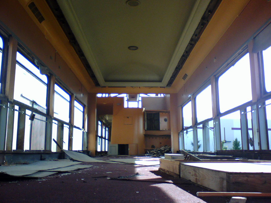

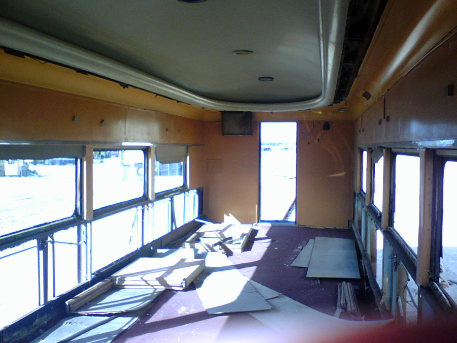

Attached are some recent photos of the Utah State Railroad Museum's ex-Train of Tomorrow dome car 'Moon Glow'. Not wishing to level any unnecessary criticism of the organization, but suffice it to say that it's as vulnerable and unprotected as the pictures show, having been shoved outside mid-restoration some years ago minus all glazing and many of its side sheets. Still, I was surprised that the interior wasn't in even worse shape. Some would say this car isn't worth saving and I might agree if it wasn't the only remaining 'Train of Tomorrow' car in existence.
I posted a full series of pics over on 'Trainorders':
http://www.trainorders.com/discussion/r ... ?4,2589800
There was a little bit of interest in raising money to at least get some tarps put over the poor thing before another Utah winter sets in. Can anyone here give a knowledgeable estimate on what it might cost for the necessary tarps, tie-downs, etc? If I approach the museum with a proposed solution I'd like to have some realistic numbers behind it. Thanks.

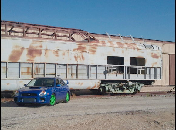

BTW... the pic with the Subaru WRX in it isn't mine-- I happened to find it as part of an online classified ad which prompted me to visit the car and take the interior pics.
