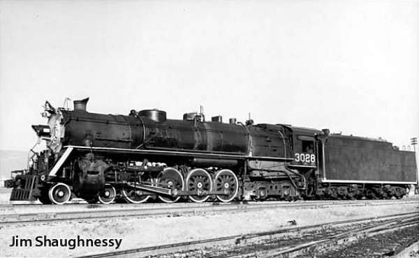

Hi Everyone, Does anyone know the current status of NdeM 4-8-4 3028 on the New Hope & Ivyland? Is she still being overhaulled for NH&I operations or is she going back to New York State? Does the Great North Eastern Railroad Foundation still have long term plans for this locomotive? Thanks - David Notarius, London UK, ex New Hope PA

As a part time engineer on the NH&I I can report that slow but steady progress is being made on the 3028 ( sort of a rainy day project that gets worked on when time&budget allow) and there are plans to run it on the NH&I whenever it gets done.
I wouldn't expect it anytime soon.

IMHO there's no substance at all regarding the 3028 moving back to NY State.

The smokebox looks disproportionately long, to me. Why is that?

Those NdeM 4-8-4s were both modern and antique at once: cast engine beds (and cast water bottom tenders), dome throttles, no mechanical lubrication, Penberthy injectors. The long smokebox is the result of no combustion chamber, I think.

Penberthy? Sounds reasonable for the tinker toys, but not on a 4-8-4.
It does have a combustion chamber, as evidenced by the staybolt pattern.
http://rrpicturearchives.net/showPictur ... id=2273322

I've seen quite a bit of these Mexican 4-8-4s in books that I've taken out from Worcester Public Library, or in my own collection of books and magazines. These ones remind me of the Australian 4-8-4s (500 class 4-8-4 rebuilds, minus side skirting). But, i didn't realize that these 4-8-4s were basically built with obsolete practice. My thought is that all large, modern steam locomotives were build with more modern refinements. Honestly, I thought the dome was a sand dome of some sort...

Yes, Penberthys. I've seen the ones on 3028. And they are prominent in close-in photos of native women drawing hot water off the overflows, as shown in Ron Ziel's "Twilight Of Steam" book.
