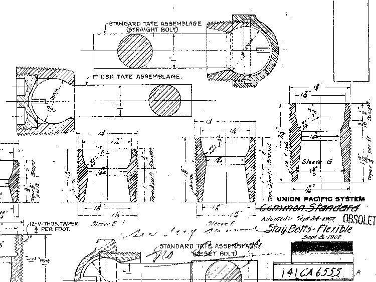

Draw your own conclusions:
1. The TATE brand of Flannery Flexible staybolts were ADOPTED as "COMMON STANDARD" for the HARRIMAN STANDARD FLEET OF STEAM LOCOMOTIVES as of Sept. 26, 1902. UNION PACIFIC STANDARD PRACTICE dictated use of FLANNERY flexible staybolts until the end of steam.
