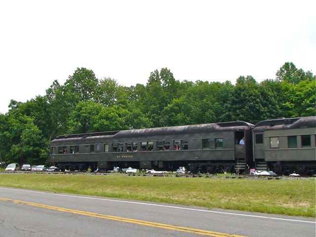

No, Mt. Baxter is still owned by the Midwest Railway Preservation Society in Cleveland, as it has been owned by them and predecessor Midwest Railway Historical Foundation (the former equipment owning arm of Midwest Chapter, NRHS) since 1962, when it was acquired from the L&N(?) and renamed John S. Foster, for the former W&LE engineer and Midwest Chapter co-founder. It carried the Foster name and blue paint until the early 1980's, when it was refurbished and reverted back to it's historic Pullman name.
The car had not operated behind a train since the mid-'90's before the recent July 4th weekend, when it was part of the Kent Festival train rides on July 2nd running from the former A&GW/Erie station down the connection with the Wheeling, and then South for several miles to South of Howe Rd. Premium seats in the car were just about sold out for the entire day. According to Midwest members hosting the train that day, it took a concerted effort to get the car finished and able to run on the train. Two weeks before the trips, the car was still up on jacks.
If I can get it to work, here is a digi image of the car operating that day.
File comment: MRPS Pullman "Mt. Baxter", Kent Festival, Kent, OH, July 2, 2011
