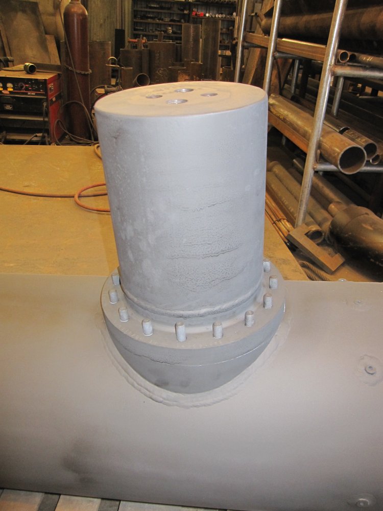

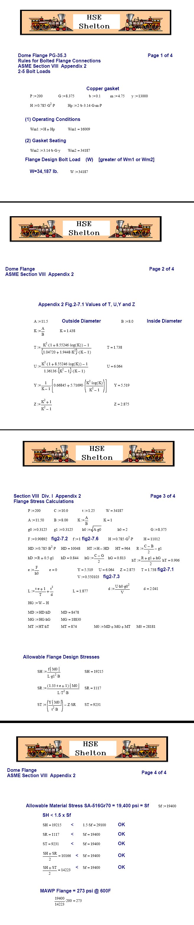

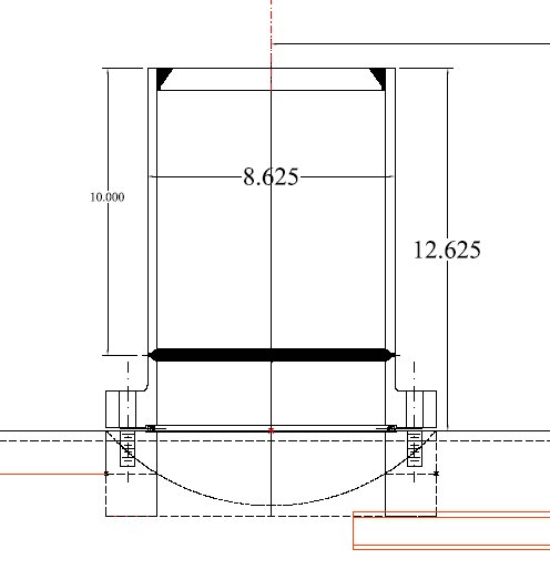

As Wolf said, calculus is used to derive the stress equations. Here is an example of real world ASME Code math. These are the equations for the detachable dome flange for Redwood Valley Railway's new boiler for Locomotive #4.
