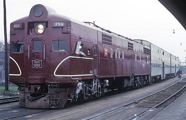

Why did C&NW build cabs at all when they had a couple perfectly good examples across town on how to do it even more cheaply?
CRIP750-650421 AB6, Englewood Union Station, Chicago, IL.jpg [ 288.77 KiB | Viewed 6947 times ]
Why? Protection for the crew in case of a grade crossing accident!
I'd much rather ride higher up, with a nose full of collision posts, than low down, right at semi-cab height.
Doesn't count. Rock Island had these two AB6 units built this way by EMD for the two sections of the Rocky Mountain Rocket; they weren't in-house rebuilds.
