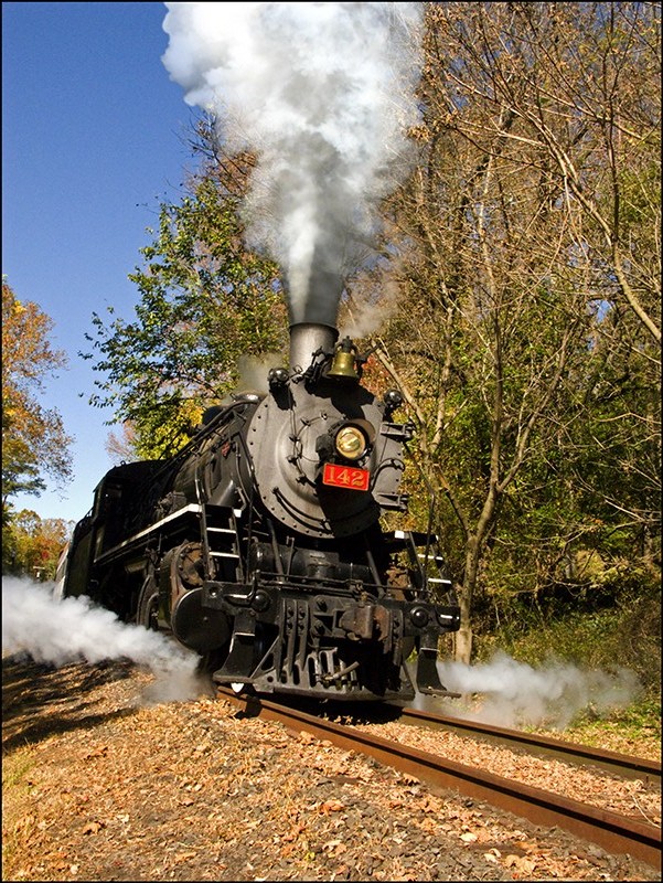

The folks at the New York, Susquehanna & Western Technical & Historical Society http://www.nyswths.org will be operating a fundraising event to benefit the Whippany Railway Museum's http://www.WhippanyRailwayMuseum.net Steam Locomotive No. 4039, which is currently being rehabbed for a return to full operation.
The event will be held on Saturday, August 6, 2011 at the NYS&WT&HS' Phillipsburg, NJ site. Many of the key people at both NYS&WT&HS and WRyM volunteered together on the Morris County Central Railroad at both Whippany and Newfoundland, NJ in the 1960's and 1970's. No. 4039 (US Army ALCO 1942) ran in MCC excursion service with stablemate No. 385 (an ex-SR 2-8-0 built in 1907), also preserved at WRyM.
Plans include unlimited rides on the Delaware River Railroad Excursion train, photo run-bys, a picnic, night photo session and a tour of the Friends of the New Jersey Transportation Heritage Center's 1913 Triple Expansion Steam Pumping Engine at P-Burg.
For full details on how to purchase tickets, go to: http://877trainride.com/4039.htm or: http://www.WhippanyRailwayMuseum.net/in ... team-train
