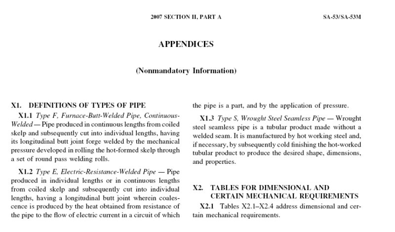

 Post subject: Forged Lap Seam ASME CODE
PostPosted: Sun Jun 05, 2011 3:58 pm
Posts: 488
John,
You must have the ASME Code books if you have a Code shop.
If you are going to publish educational videos, you should do research so as not to lead people astray.
Matt Austin

 Post subject: Re: Forged Lap Seam Boiler VIDEO
PostPosted: Sun Jun 05, 2011 10:51 pm
Posts: 374
Matt,
Thank you very much for the note. In the discussion over at Smoksatk and off line I have had discussions with others about the comment I made in the video. First, I am very much aware of how materials, like SA 106 are made. I am very much aware of the fact that the seam is a forging and then the material is extruded through a die. Thus creating a "seamless tube".
From a welders standpoint: When you weld a piece of SA 106 for a weld test, there is with-in the tube a visible mark where the joint was made prior to the extrusion process occurred. When you set up a weld test, you look for the marks, line them up and weld the test out. We do this as we have learned that by not matching up the "seams" for lack of a better word, you can and often do end up with testing problems in that area.
Likewise, as I have explained elsewhere, I do not work from a strict script and often I get ahead of myself. There is a comment above about ERW pipe and tubing, which, when you are welding these pipes or tubes, you want to focus on the seams or the joints.
As I have said before.....my videos are not perfect. I make them as a way to share some general information without making them so deep that they can be understood by the person trying to learn, nor some complicated that only a few of us could debate the issue.
Matt, I have received far more positive notes about this video then I have negative and even the negative was simply a clarification....which has now been made.
I have not lead people astray....I have miss-placed a well intentioned comment for a deeper content discussion!
Kindly yours,
John E. Rimmasch
Wasatch Railroad Contractors
