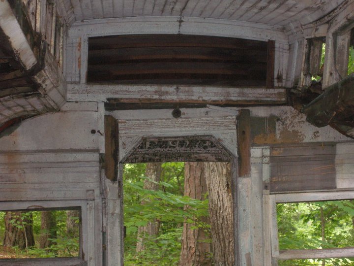

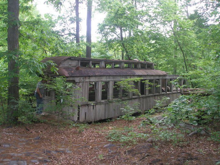

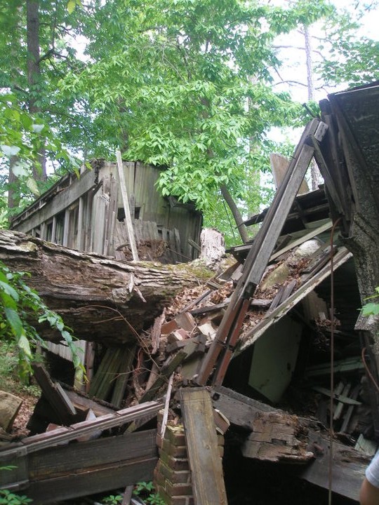

Acting on a comment made by an RYPN poster and connecting the dots with an off-hand encounter on another forum, I have found somewhat of a rarity in the southeast. No, its not a lost locomotive, but it is apparently a circa 1880's narrow gauge passenger car... For the purposes of protecting the car until our organization can acquire it, or the owner burns it or lets it rot, all I will say is that it is located south of Richmond, north of Cuba, and east of the Mississippi.
However, what I would like to know is:
a) Does the RYPN community think this car is significant enough to restore. Counting sills, MAYBE 35% of the car's orginal fabric can be used. Lots of damage, lots of rot.
b) Anybody have a guess as to the manufacturer of the car? Jackson & Sharpe; Billmeyer & Small??
Take a look at the photos attached

But more seriously, while a significant project, it would fill a hole in collection of the great museum you guys are building. Narrow gauge passenger cars from the SE are extremely rare. What do we have? The Tweetsie tripple combine, the W&W car that spent time in Florida (IIRC) before going to CAMA and the short chunk of the SS&S baggage car in Dendron. That's all I am aware of. While this car is bad, it looks like what some of the craftsman with the Maine 2 footers have started with, on some of their saves.

Some of the wood work is hand carved stuff, beyond the time/money equation in today's world. I agree with Steve. Saved whatever is salvageable, photo-document, measure, part-out anything that remains. Most of the car is lost, yet the manner in which it was originally constructed can be recorded and pieces saved. To let it go further into decay seems a greater waste. Be prepared for about 12 years of every weekend, and plenty of donations in materials, cash, and labor.

While I would like to save every thing that I come across, this is one I would walk away from.
Do an extensive photo documentation, save some or part of "good" sections for display, hardware, ect. and then walk away.

What about just saving the most salvageable portion (to one side or the other of the tree impact, perhaps?) and setting it up for an interpretative display. Maybe use a half or a third of the car with that portion lovingly restored. To attempt the whole car seems to be a bit much. Sometimes, with a project like this, it can drag the rest of your team down with it. I call these "quicksand" projects. Just like a General on the battlefield, before beginning a project you have to know where the victory is. IMHO.

You need to check the remaining window frames and top deck window surrounds for car numbers and LOT numbers then we can start the search for its history. I would suggest its a documentation and salvage excercise. Let us know what you find, someone removed the bulkhead vent panel which may exist somewhere which would have had the car number, but the remaining door frames may hold the key too.

Just to add.....The windows are paired very much like our Pullman so my money is on that, however other manufacturers did that too.
