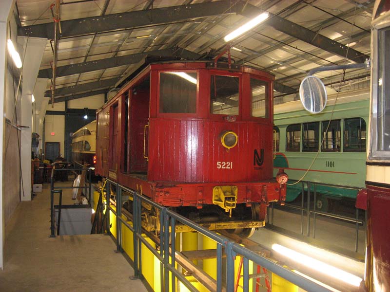

We have both a bridge pit and walled pit. Someone's regs required that we install a removable railing system to prevent falling into the pit.
Wesley

Well here is the one at the Railroad Museum of New England Image
