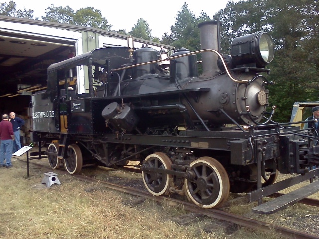

Ladies and Gentlemen,
I have been reading on here for quite some time, and now have come to something that I think is worthy of a post. I am a volunteer at the Passumpsic Railroad in VT. It's a private museum owned by the Kendall Family. We are in the process of doing some major work to their Heisler to get it back out and running for the August timeframe. One of the big things I have to do involves removing the packing glands (amongst other things). Doesn't sound like a big deal, but we don't have a wrench to get in on the nut. I was wondering if any of the Heisler guys out there could tell me
A. What you have made to do it
or
B. Where can I find an offset spanner of that size to get onto the nut and still clear the Crosshead guide casting.
Thanks in advance for your help, I'm very new to working on logging locomotives, so I hope that some of you guys with a lot more experience will be able to help me out from time to time as I am getting my feet wet. We have machined up a "contingency plan", but if I can get the right tool, I would rather do that.

My experience was with a Stearns built Heisler of 1899 vintage so this information may not be relevant to your engine. Check to see if there is a keeper for the packing gland threaded into the cross head guide and engaging the ribs of the packing gland. If there is one there, remove it and stick a piece of round bar with the end ground flat on the top. Use the guide casting as a fulcrum and press against the ribs on the packing gland, trying to rotate the gland in the loosening direction.

Thanks for the info! there is a keeper on our engine. It's kind of a pain to get in and out, but I will give that a try. That will be a lot better than fighting with the gland. The railroad is private, but we do invite people to come and visit as long as they get a hold of us first to make sure that we are there. Work days are every Sunday (for the most part) and a few other days here and there depending on who is around. We are always looking for more people who are interested in helping out with everything from working on the locomotives to trackwork. When you come up, you can see the second Heisler that is still waiting restoration. The web site for the railroad is at

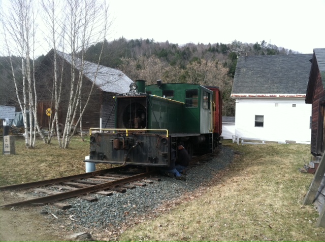

We have been doing a lot of work on the 5214 as of late. The air assited clutch is out of it, and we have pulled the radiator to rebuild it. There has been an issues with shifting the engine and some coolant leaks, so we hope to get rid of those little "gremlins" as soon as we can.
Heisler #1 is still resting in the enginehouse soundly. We have still not been able to find a wrench for removing the packing gland nuts, so if anyone has any ideas I would be very grateful. Nothing wel have tried so far has worked (however, that being said we have not really tried that hard as of late). I have included a picture of the plymouth from the other work day, and a picture of #1. Enjoy, and I will be happy to answer any questions anyone may have. Work days are every Sunday, and we can always use a hand.

Like one of the other posts said:
1. Make sure the keeper pin is all the way out, sometimes takes a helper to hold it out.
2. Use a straight pry bar about 2 feet long with one end flat and at a slight bend to the shaft. Move the packing nut one slot at a time until loose enough to turn by hand. If it has just been running it will be very hot, we usually try to install new packing in the morning for that reason. Depending on the angle you can work at. sometimes you need to turn the curved end up or down to engage the slot. Takes some practice, but goes fairly quick once you get the hang of it.
3. Reverse to tighten.
4. Enjoy the lack of steam blowing by the old packing as you cruise down the track.

Thank you very much. I'm all for that, but the owner doesn't really like that idea too much. We may have no choice though, if that's what all the other Heisler owners are doing, then it must be the way to go. Next steam day I'll give that a try. Would it also make it easier to do if we heat the nut a little and then apply preasure with the pry bar? I'm not a fan of using the tourch for every nut on the thing....but in this case....may not really have a choice.
