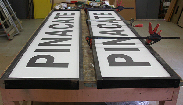

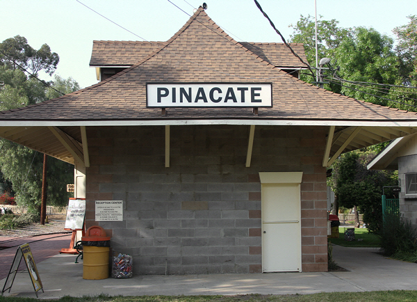

PINACATE Station Signs at Orange Empire Ry Museum (see pictures).
Recently I was asked if I could make station signs for the roof of the museum's station (bookstore). The building is not historic, build by volunteers a few decades ago. Pinacate was a mining region southwest of Perris, CA and the Mexican name of a beetle.
The sign material is e-panel, a composite of two pre-painted sheets of .008" aluminum with a solid polyethylene core, printed, and given protective finishing coat. I made the frame and bracing out of TREX, recycled plastic (PVC) composite boards usually used as decking. Coated deck screws and construction cement hold it all together. This all means zero maintenance (I hope).
The cost to the was museum about $350 for the signs and other materials. E-panel is a 3M product and I assume 3M should be able to help you find a sign maker using it in your area.
