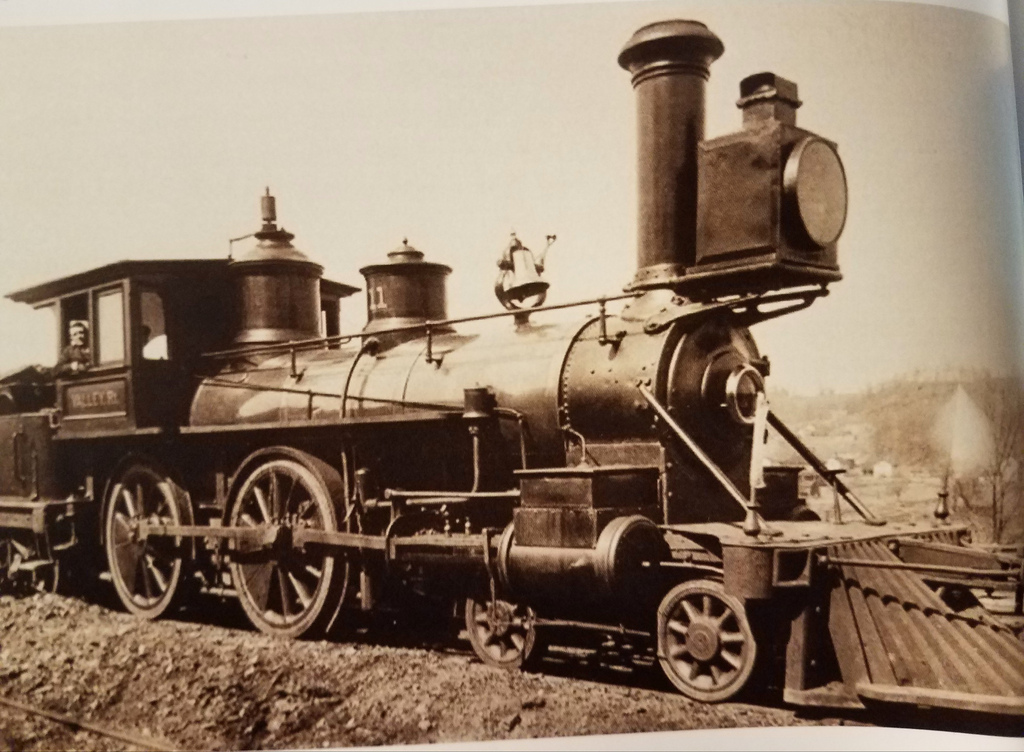

The Valley Railway had 4-4-0s built by Baldwin numbered from 3-9 in 1878-1880. There appears to be a gap for 4-4-0s numbered 10-12, which seem to be built by a different company in 1880 or 1881. I have a photo of #11 attached, and was wondering maybe you or someone else could help me identify who built it. My thoughts are either Pittsburgh or Hinkley.
Matt
