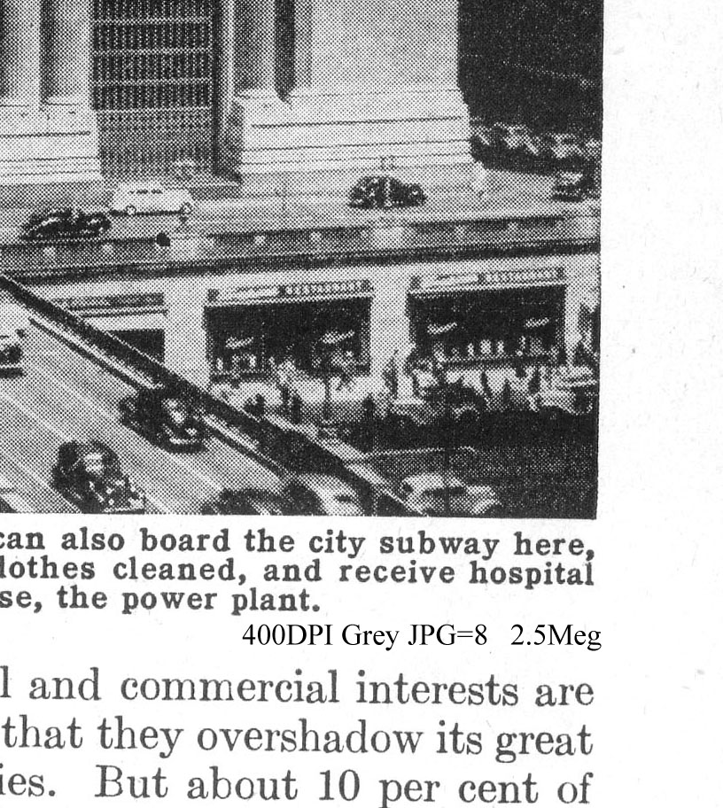

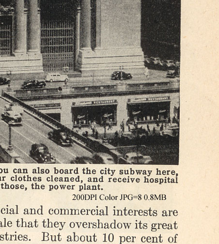

Text isn’t too bad at 200dpi, I generally do not use color when scanning black and white. Halftone images are a problem, even at 400 dpi I can see moray. I use 300 or even 400dpi grayscale for pictures. To trade off file size I then tweak contrast and use about an 8 on the JPG compression.
A 400 DPI grey set an 8 after using the level function to clip some of the “dirt” out of the whites will be about 1.5MB.
Don’t know how this will look when I post but here is color at 200 vs. grayscale at 400. Extra points for knowing the location.

I think the samples posted make my point. The 200 dpi color looks more "real" and complete than the 400 dpi greyscale, and it's even a smaller file size.
TigerDirect has a 2TB disk for $80. That is 2,000,000 mb, or about 2 million pages at the quoted rate per page.

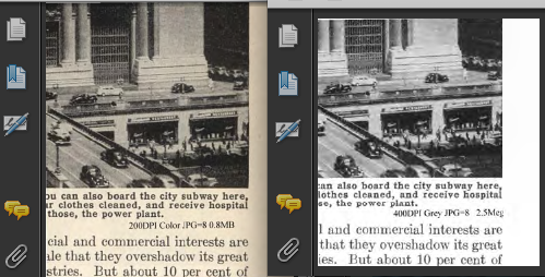

WHOA, WHOA, WHOA!!! FOLKS!!! The current discussion completely misses the boat!
Scanning it is pointless if you can't find it again.
Many of you are "spoiled" by the type of annotated PDF files you see on Google Books. The ones where you're looking at something obviously scanned, yet magically if you drag your mouse across it, you pick up plain text you can cut-n-paste into Microsoft Word. This is not magic. You have to make it happen.
The PDF format allows the image to be tagged. A tag calls out a rectangle in the document and says "This glob of gray is the word 'hello'." When you sweep your mouse across it, you are picking up those tags. You notice this DOESN'T work on Buzz's images posted above. They are not tagged in this manner.
How do you make the tags? Typically your PDF authoring tool does that for you (if it can). It uses OCR, which requires enormous amounts of processor power, and works best on a high quality scan.
How do you keep a sane file size after the OCR is complete? Aha, you're not the first to ask. Adobe Acrobat is way ahead of you, it has features to let you compress the document to any degree you like. The key is starting with the highest resolution possible to begin with, so Acrobat has the most raw data to work with.
Buzz is saying "Hey, lower resolution makes a smaller JPEG" -- maybe, but it does not make smaller PDF's.
I loaded both of his JPEGs into Adobe Acrobat, did OCR on them and then hit "Reduce file size."
His 400 DPI JPEG -->> was 240kb --> reduced to 18kb
His 200 DPI JPEG -->> was 92kb --> reduced to 33kb
That's right. The higher resolution JPEG actually resulted in a lower resolution PDF, because Acrobat had more raw data to work with. It also did a better job with the OCR. (emphasis mine)

As for the image quality, Buzz and Lex are getting excited about artifacts of the halftone. At 200 DPI, his scanner software caught the halftone and converted it into grayscale for him, and that looks "oh so pretty". At 400 dpi, it's actually scanning the halftone proper, which offends the eye. Wrong conclusion. If you have excess resolution, you can always sample down. That is exactly what Acrobat's "Reduce file size" does with this halftone. Remember, letting Acrobat convert the 400dpi halftone resulted in a smaller file in the end. Adobe knows what they're doing.
Left is 36kb Right is 20kb
You're looking at a screensnap of the the pages in Adobe Acrobat side by side. (The darkness of the text is a function of the original scan and the resolution I'm viewing it at here. Fix that in scanner settings.) With both, you can mouse across them and pick up the text words. Typing "commercial interests" into my PC's search engine and both documents are found because of PDF's annotations.
