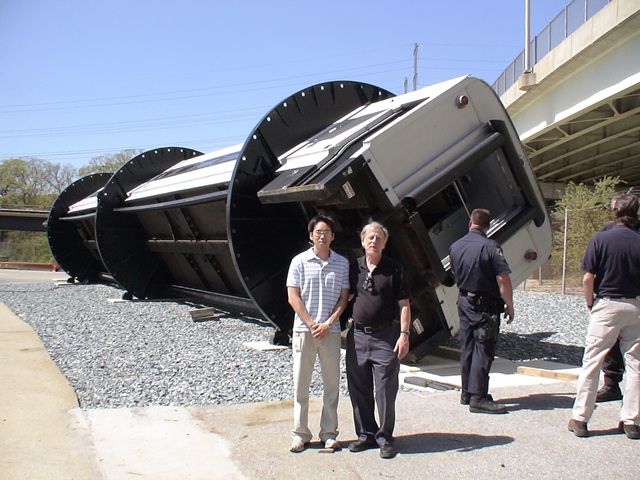

This isn't just for wood cars. When I was a equipment specialist (read junior, junior project engineer) on a new passenger car build in the '90's, the new cars we were building at the time were built with 5/8-3/4" camber.
About five years ago I was staff engineer at a company which had a government grant to build a "roll over rig"; a retired NJT "Comet" car that could be placed at any position from plumb to 180 degrees for the training of emergency responders (black-out car, fill with smoke, tilt 45 degrees, remove occupants). Three "hoops" were constructed, and three concrete and roller fixtures were laid to accomodate the pivoting via a capstan winch. Two newly college minted ME's worked out the hoops in CAD, with very precise measurements to clamp to the carbody, and in passing I asked:
"What did you do about the camber?"
"What camber?"
"The center of the car is 1" higher than the ends."
"Really. Won't the car flex?"
"No."
Upon laser transiting, it was found that the camber of a 35 year old Comet car was still 1 1/8" at the center. Thankfully, the young engineers moved the Comet car "hole" for the center hoop 1 1/8" off center before ordering or cutting any metal.
