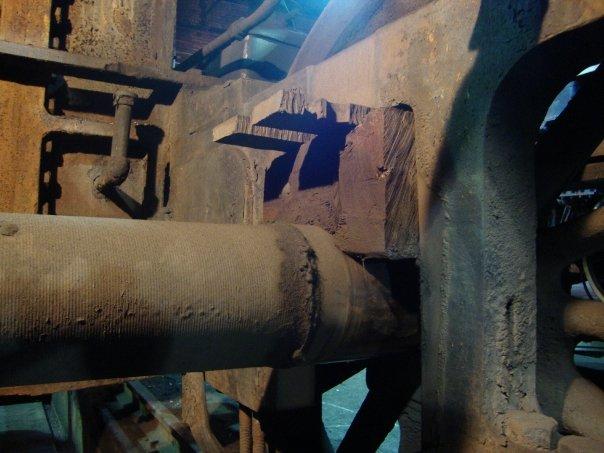

Before the 565 can be moved, we have to install the front truck and no. 1 driver journals. Right now the axle is sitting on some wood that's piled up in the frame.

How did the front driving boxes vanish? Seems like an unusual part to remove, especially if the drivers are still in place. And no pedestal binder, either. Did this happen in the "New Hope days", when 565 was stored/worked on there?
Hub Liner, CT
