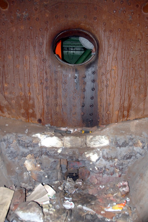

Also, if the locomotive had a mechanical stoker such as an HT or BK, the entire fire door opening would have to be reconfigured, as was done on CNR 6077 for example.
