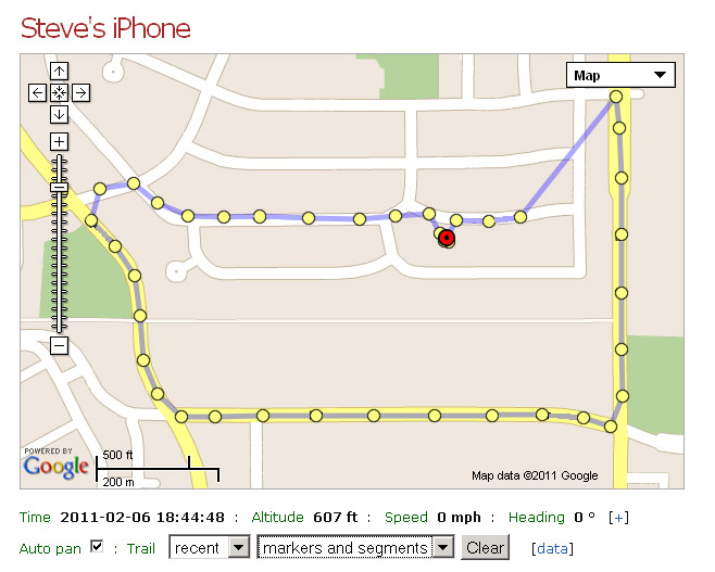

While I'm sure a dedicated solution would likely work better you could probably do it for free with an iPhone or other GPS-equipped smart phone (provided someone has one and is willing to be without it for the duration of the move). Just stash a car battery and car charger cord aboard.
There are probably various applications that can do this. One I've noticed (but have not yet tried) is called InstaMapper and is a free app..

I gave InstaMapper a try and took a drive around the block. Cost was zero.
Steve
