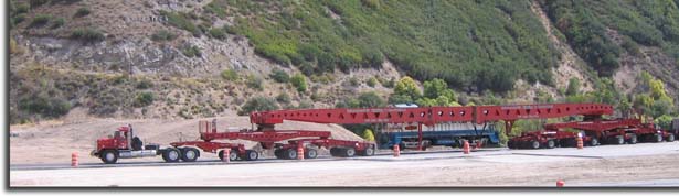

With all the talk about 643 I've been thinking about the issues of moving a steamer with friction bearings. If it's not land locked.
In the attached picture that someone has moved a diesel. Could something like be made and used to move a steamer on rails. What I mean is can't we just replace the rubber tires with steel rail wheels and trucks? Maybe shorten it up not sure if the length is an issue. Would the big railroads allow this? You would only have to have the wheels of the steamer off the tracks by several inches. Just a thought. Yeah I know who is going to pay for it.

Not too long ago, I was brainstorming with another regular on RyPN about using a Schnabel car to transport railroad equipment, by use of a "cradle" that would form the load to be mounted between the Schnabel end units.
I'm not an engineer (mechanical or structural), but I suspect it could work, at least for rolling stock and locomotives up to about 130 tons/60 feet length.
Paying for it and getting the railroads to agree to moving it are some significant hurdles to overcome. But a self-contained "over-dimension" load is probably less scary than moving a steam locomotive, for example.

A similar rig was used a couple years ago, I believe, to move a UP 4-8-4 (No. 833?) from Salt Lake City to Ogden, and I think I remember a Challenger was moved the same way. You can move anything if you have enough money.

The thought that occurs to me, looking at this:
IF such a rail rig works in a manner that would be deemed acceptable to the railroads accepting the shipment, it's very likely that such a load would either be outrageously incapable of most clearances (both height and lateral clearances), or it would require such specialized handling, oversight, and administration as to push the price into the ionosphere.
Or both.
The rig described by Brother Laepple was a roadway rig, not a rail rig. And note the shot of 4023 includes a rig MUCH wider than standard gauge or even Hitler's proposed super-gauge.......

Well if you could get the rail trucks under it, that would eliminate the whole friction bearing issue. We are still looking at the picture I attached. Only issues would be the height, width, and length and would that be an issue for the railroad? 611 wouldn't have been dead-towed and the risk of damage to her bearings would have be eliminated. Plus is it 1351? which is on hold for train fest would be able to be moved without issues. Not a railroad guy so I don't know what clearances needed for loads that would be hanging over the width of the rails.

It depends what rail lines you're on. On some multi-track lines with vertical clearances for double-stack container trains, it wouldn't be so bad. On the other hand, there are rail lines incapable of even handling six-axle diesels.
Railroads have their own specialists who keep records on what the clearances are supposed to be on any rail line on their system, or at least can cite the AAR "plate clearance" (a template through which given cars, loads, etc. are supposed to be able to fit) of a given branch. It can take but one bridge, tunnel, or overpass to impose a detour of several hundred miles. There are a scant few rail lines where the major reason the line still exists is as a "high-wide" route--one of these is the line down the Delmarva Peninsula and across the Chesapeake Bay car float.
UP 3985, which was supposed to be identical to Clinchfield 4-6-6-4's, encountered some clearance problems when it ran on the Clinchfield several years back. And that was on its own wheels.

There are many limitations to the load you can transport over highways including the total weight load on bridges, the loading per tire on pavement, the clearance issues, and how much chaos local authorities will allow you to generate on the shipment route. As you can see from the examples cited previously, moving a 120 ton diesel switcher requires a very big rig, moving a 450 ton steam locomotive puts you in the same realm as moving a building.
I still think that in cases where weight and size make a single load highway or rail move impractical, partial disassembly with expert attention to weights, clearances, and loading can make highway transportation of some locomotives more feasible, although requiring more trips, more permits, more escorts, and possibly greater expense.

The roads around Pittsburgh where 643 is, with many bridges and tunnels, would never accommodate a rig such as that.

[quote="G. W. Laepple"]A similar rig was used a couple years ago, I believe, to move a UP 4-8-4 (No. 833?) from Salt Lake City to Ogden, and I think I remember a Challenger was moved the same way. You can move anything if you have enough money.
That is the very same rig and company that moved UP 833 from Salt lake to Ogden up I-15. That picture is of when we moved ex-UP NW-2 #1043 from Pacific States Cast Iron Pipe in Provo, UT to Heber City, UT a couple years ago.
That rig can stretch to a maximum inside length of 300 ft and maximum "inside the cage" width of 30 ft. The size of the trailer is assembled to what ever dimension the load will be before the truck leaves home base. The wheels on the locomotive were only 6" off the ground for the "ride". Each tower on either end of the "bridge" that the load is supporter by has hydraulic rams that can raise or lower the load en-route, if needed.
This same rig also recently moved the UP 2295 in Boise, ID from a Park to the Depot in town.
I'd be happy to answer any questions anyone would have from when I used this method.
