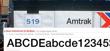

I cannot say for the numberboard, but the side numbers are either Regular Helvetica or Medium Helvetica.
Steve
Yeah, looks to be Helvetica. At least that font's easy to find and use. ;)

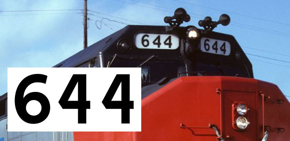

So, what does RYPN think of this?
I used WhatTheFont (WTF) to upload an image and identify a matching font. It pointed me towards Churchward Designs Regular. CDR isn't quite the winner just yet, because while most of the numerals on there are a great match, the "0" and "1" numerals don't resemble what the SDP40Fs had. This might be due to this font being upgraded or modified since the 70s, the latest modification happened just a few years ago. If that's the case, then there's a good chance that this font was applied to SDP40F numberboards.
I posted a thread on the font website asking for any further guidance. Otherwise, this font seems to be the best bet for new numberboards.

The six looks dead on Chris, but the fours don't. Notice that the "triangle" in the fours on the locomotive look like 45-degree triangles, while those on your new font look like 30-60-90's.
Walt
