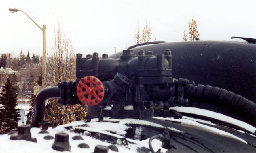

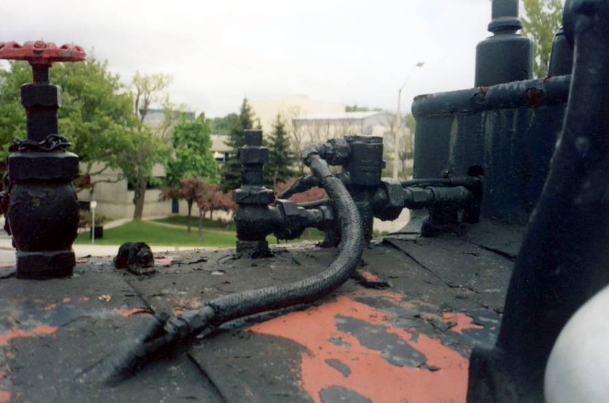

The "Front cooling valve" is incorperated into the check valve, which on this engine is located near the front tube sheet. The "rear cooling valve" is located in front of the safety valves, in the middle of the boiler, but in reality it just ahead of the rear tube sheet, as the engine is equipped with a combustion chamber.
File comment: front cooling valve incorperated into boiler check valve. Notice that a bolt is missing on the check valve. I've noticed that a number of things on the engine are often missing a bolt...
File comment: Left to right: Rear Cooling Valve, NALCo Contnuous Blowdown Valve, Safety Valves.
