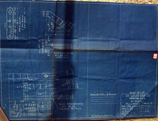

When the British Columbia Electric Railway Co. became BC Hydro Railway and then sold to what became Southern Railway Of BC it left behind a filing cabinet of old blueprints. Some dating back to 1905. Cataloging of the entire collection is now taking place.
There is one blue print that is named "G" Truck Details for I.T.S. Urbana & Champaign. Research indicate Urbana & Champaign is a metropolitan area in east central Illinois.
I am looking for information on what the I.T.S. may mean. If it is a long ago rail system then I might be able to find out its different cars and how this particular blueprint fits with BCER cars.
Any help is appreciated.

I.T.S. is the Illinois Traction System (Reporting Marks ITS)
In the late 1920s or early 1930s, the I.T.S. merged with a couple of St. Louis-area steam terminal railroads. and changed the name of the unified system to the Illinois Terminal System (Reporting Marks ITC)

Sleeper/observation "Champaign" later became parlor/obs #234 and is preserved in Union IL

Nope. Urbana was IT 511, one of five reserved-seat cars built as trailers by St. Louis Car in 1911, 57'6", seating 35, re-equipped 1928 with one truck from a 280-series car. Rebuilt with furniture and window upgrades 1930 and 1936. 510 and 511 sold for scrap 11-13-1950.
Champaign is the sleeper that was sold to the Illini Railroad Club in Feb. 1956. (Built in 1910, that car has a convoluted history which I'm not re-typing here.)
Nothing whatsoever from Illinois Transit/Terminal is mentioned in Henry Ewert's The Story of the B.C. Electric Railway Company (1986)
My only presumption is that somehow something ran at B.C. Electric with identical trucks, and they found the prints useful. Absent any generalized need for exchangeable truck data (and I'll leave the details of trucks, motors, etc. to better traction guys than me), you might want to gift these prints to the IRM.........

I would think this is more likely to refer to the Urbana & Champaign street railway system, which was a part of the ITS empire. Looking at the diagram, we would be able to tell whether it's a street railway or interurban truck.

Also quote:"My only presumption is that somehow something ran at B.C. Electric with identical trucks, and they found the prints useful. Absent any generalized need for exchangeable truck data (and I'll leave the details of trucks, motors, etc. to better traction guys than me), you might want to gift these prints to the IRM.......
Recent research has indicated that perhaps the identical BCER truck, or truck part, is the reason for the I.T.S. Urbana & Champaign blueprint. The key is the "G" truck.
I offer the blueprint for your opinion.
