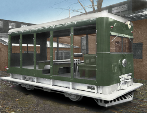

We're working on the restoration of a 1940 Brookville railcar built for the Army, but the armoring is probably not you have in mind... 20gauge automobile sheet metal in the front, but far less on the sides... :-)
This was used entirely within the Raritan (NJ) Arsenal, so it didn't need protection from attack. However, since it carried ordinance around, the specifications did require non-sparking (ie: wood or aluminum) trim.
File comment: Colorized builder's photo
