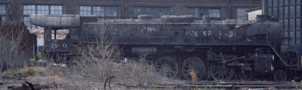

this is not my picture but i found it on the web and since were talking about 2100 without rods and possibly being on 2101 here is a good shot of her.
Matt

I remember some story that when they were sitting in the scrapyard in Baltimore someone wanted to buy the 2100 & 2101 and stage a cornfield crash. Does anyone have detail on this story or is it another steamer in the quarry story?
