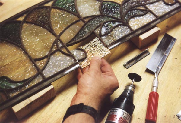

Here's an image of a minor repair I made to a stained glass window for an interurban car at the Rockhill Trolley Museum. It is all zinc came and frame. I made the spot repair since it was easily accessible without rebuilding the entire window (I've seen the normal, complete-rebuild method on other windows). After sanding the zinc to shiny metal, I was able to get what I think is an acceptable bond with my regular gel flux, 60/40 solid solder, and Weller 80W iron. I put a couple of splints on either side of the new frame joints for reinforcement. I suppose time will tell.

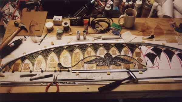

This is a complete reproduction that was needed to complete the set. The cardboard scraps under the glass pieces keep them raised up to the groove of the came, so that while things are loose and being positioned prior to soldering, the glass doesn't fall all the way out and cause a headache. The deep sockets on the table are dies for bending the zinc came by hand.

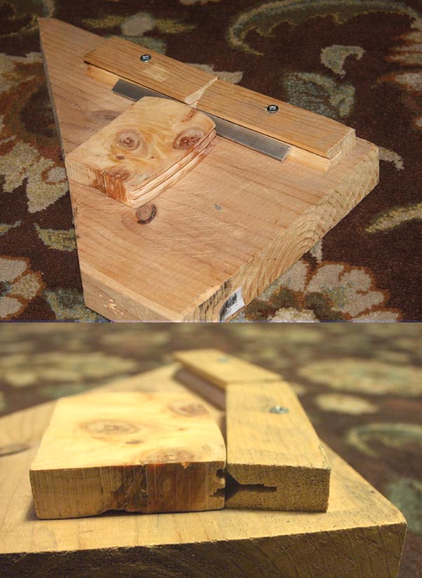

For the center of the arch, I held the zinc at either end and applied gentle pressure while pulling it across the edge of the workbench. For the tighter radii as the ends, I used this homemade jig. The upper photo has a plain metal bar stuck in for show. The twin dies can pivot as the floating die is hammered in. Grooves in the dies, shown in the lower photo, hold the profile of the frame to prevent buckling. It held up fine for one window, but it might need metal dies if one wanted to make a whole set of windows.
