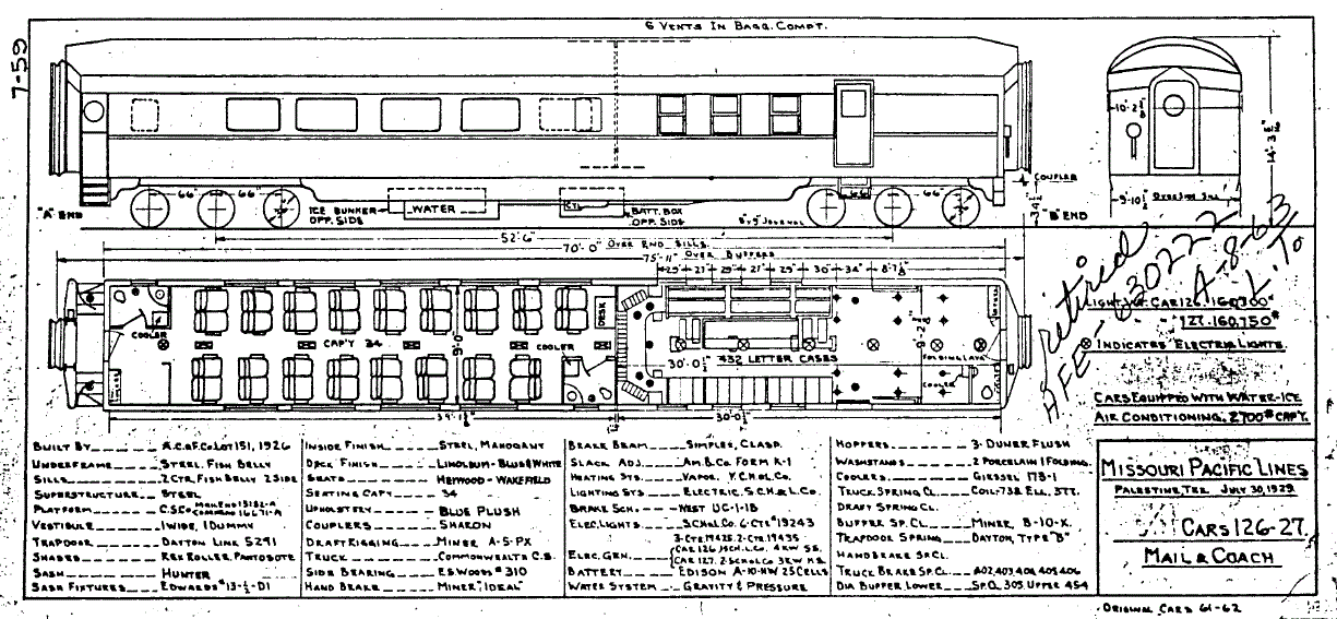

Yes, they were originally built as "Boonton" open-platform mail - coaches which were rebuilt as m.u. trailers. Definitely a good use of an unusual prototype. Some of the original cars (those not rebuilt as m.u. trailers) actually were rebuilt as baggage - coaches as time progressed, probably helping to fill a need the line had.
One of the things that made Missouri Pacific's cars so unusual was that the two cars, MP 126 and 127, were modernized to match newer streamlined equipment. The only cars to have been done in this fashion.
jerry

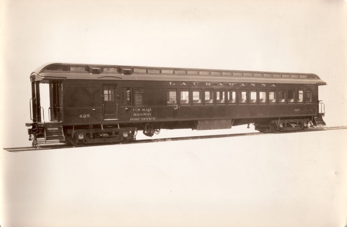

Here is a photo of DL&W #425 in RPO/Coach configuration. The car was later changed to coach/baggage configuration - the state in which it remains today. The 425 is regularly used in passenger service at Mid-Continent Railway Museum in North Freedom, Wis.

Jeff -
Thanks for the photo of DL&W #425 when it was still an RPO/coach. Being converted to a Combine makes it just one of the rather numerous examples of the coach/baggage configuration that exists in rail preservation. But at least the car survives!
