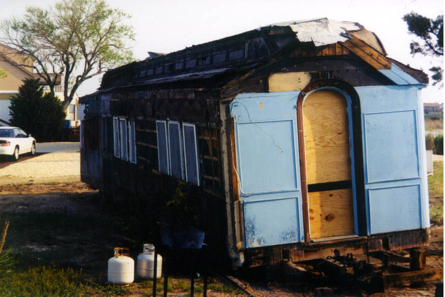

This is a topic that has always interested me, but I did not really apply the idea of the "historic fabric" until suddenly faced with it.
Back around 2000, as chairman of NJMT, we were presented with an opportunity to take ownership of a 1870s wooden PRR coach, a Pb I believe (some one can correct me on that).
Back around 1900 or so, it was moved to Seaside, NJ and positioned along the ocean with several other cars as part of a fishing camp for a group based in Philadelphia. Over the years, ocean storms and fire destroyed all but one of the cars which by 2000 had been pretty much cacooned in various add on structures and a roof over the whole mess. Through that spring we worked with the owner to uncover the car and see exactly what we had. In truth, and at first glance, it was a very well preserved wooden coach from the 1870s time frame. We had help from the good people at the RRMPA as to drawings and identification. Most wood work was intact, gold leaf was evident through out, the stain glass windows still in place, most window hardware in place. It indeed had that "original fabric." Our goal was to preserve that fabric.
We ran into two problems with the car. First was its location. Near the ocean, the salt air pretty much destroyed any iron screws, rods, truss rods, and bolts that held the car together. As a result it was going to be expensive to move it. And I mean very expensive. But we felt it worth while to preserve such a unique untouched artifact.
The second problem was an owner, who had not yet donated the car to us, who wanted souvenirs. One day we came in and all the stain glass windows were gone. Another day the gold leaf door jams were cut out. In other words, much of the original fabric was now gone. The steel frame work we were going to apply to it probably would have negatively impacted the original fabric as well.
It was my decision to walk away from the project before signing a large contract to move the car. It was the loss of the "original fabric" that drove the decision coupled with an expensive move. A well preserved, although delicate, piece of rare 1870s rolling stock was bull dozed a few weeks later buy the owner.
To me, "original fabric" hits you like a ton of bricks. You can not help but notice it. And it is worth preserving.
J.R. May
