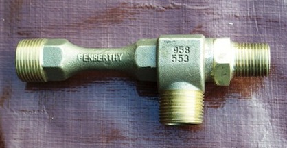

Ejectors as mentioned above are used on many different applications. Not only used to transfer water or other liquids, they are also quite often used to raise the temperature of the medium as well. They are sometimes found in chemical and manufacturing applications.
Attached is a photo of a smaller scale ejector made by Penberthy, the same people who also make injectors. This particular ejector is often used by hobby personal steamboaters to remove water from the bilge to overboard. They can also attach a hose for washing down and for fire fighting.
File comment: Pennberthy 3/4 Ejector

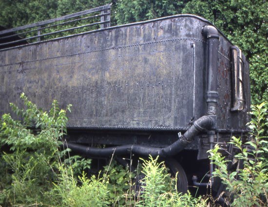

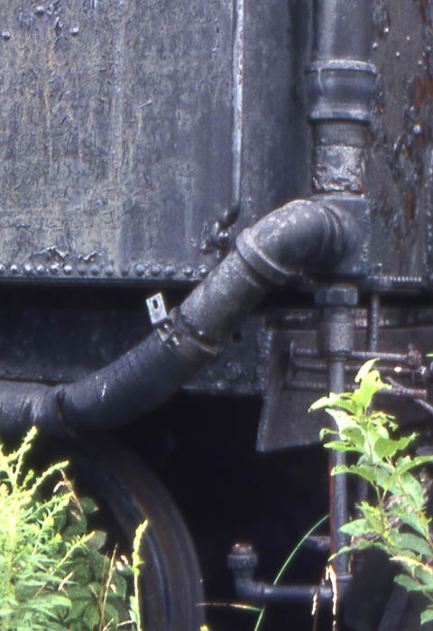

This was one of the John E. Thompson engines that was on his farm property, later relocated to the defunct winery south of Monee, IL. One of the engines that was relocated to IRM in late 2008 has also this set up but I don't think it's the same engine.
Steve
