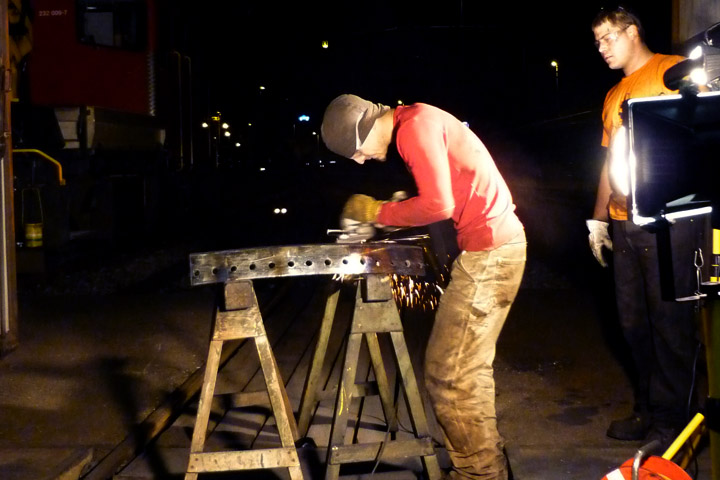

File comment: WRC's Cody Vosler preps the knuckle to be welded to the new piece of tube plate.

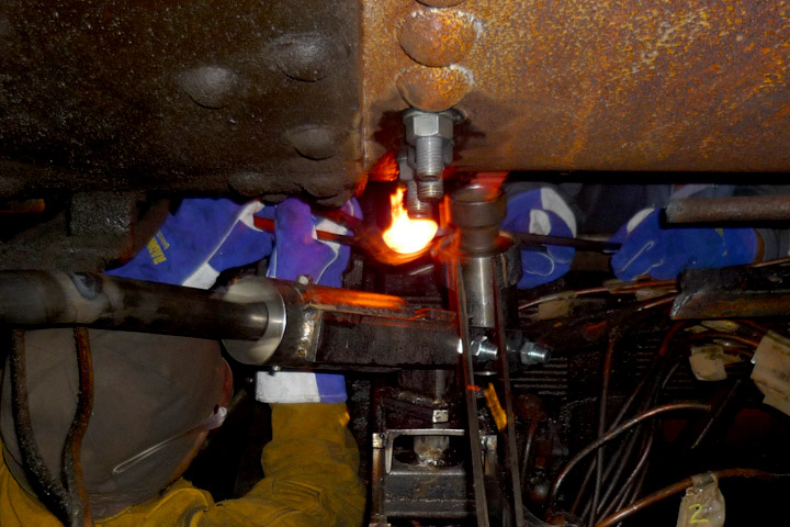

File comment: A new hot rivet about to be put in position.

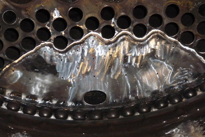

File comment: The new piece completely installed, ready for tube holes.
