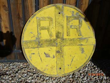

I have one of those signs. It is stamped sheet steel, 24" in diameter.

Yep that's the sign although your's is in much better shape than mine is lol. I have also found a 1907 photo with the glimpse of the sign on the telephone pole at the crossing! I am giving it to a friend to run through her photo-shop program to pull it out better
