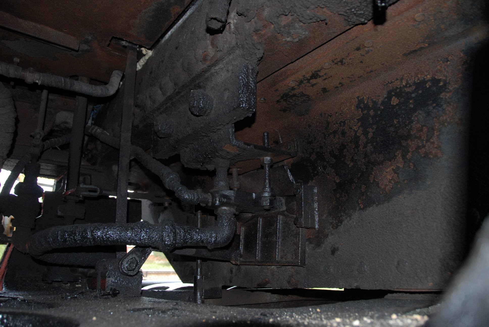

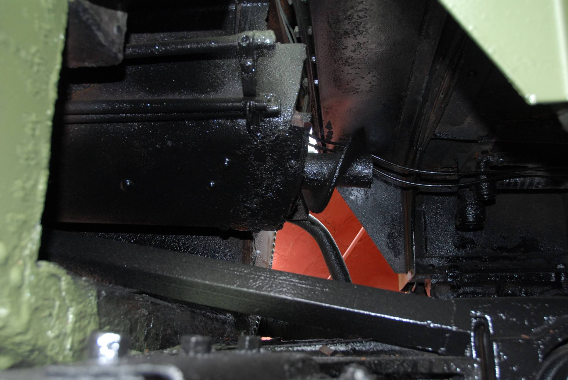

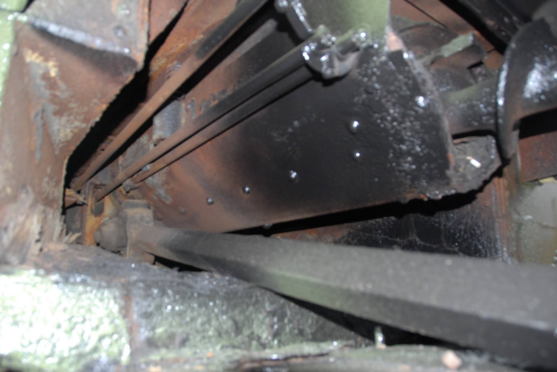

This tender also lacks a stoker motor, as it would seem that the early Northerns had their stoker engines mounted under the cab. If you visit the engine, you will see the drive shaft and what is left of the stoker screw. CN simply cut through all this in an awful attempt at backdating and kit bashes. There is also a small access hatch in the coal bunker, which I assume is to allow access to the gear box for the stoker screw.

These photos are From Grant Kingsland.
File comment: The stoker screw and drive shaft.
File comment: The stoker screw and drive shaft. The elevator pipe is of a totally different design then what was used on later engines.

File comment: The back of the oil burner

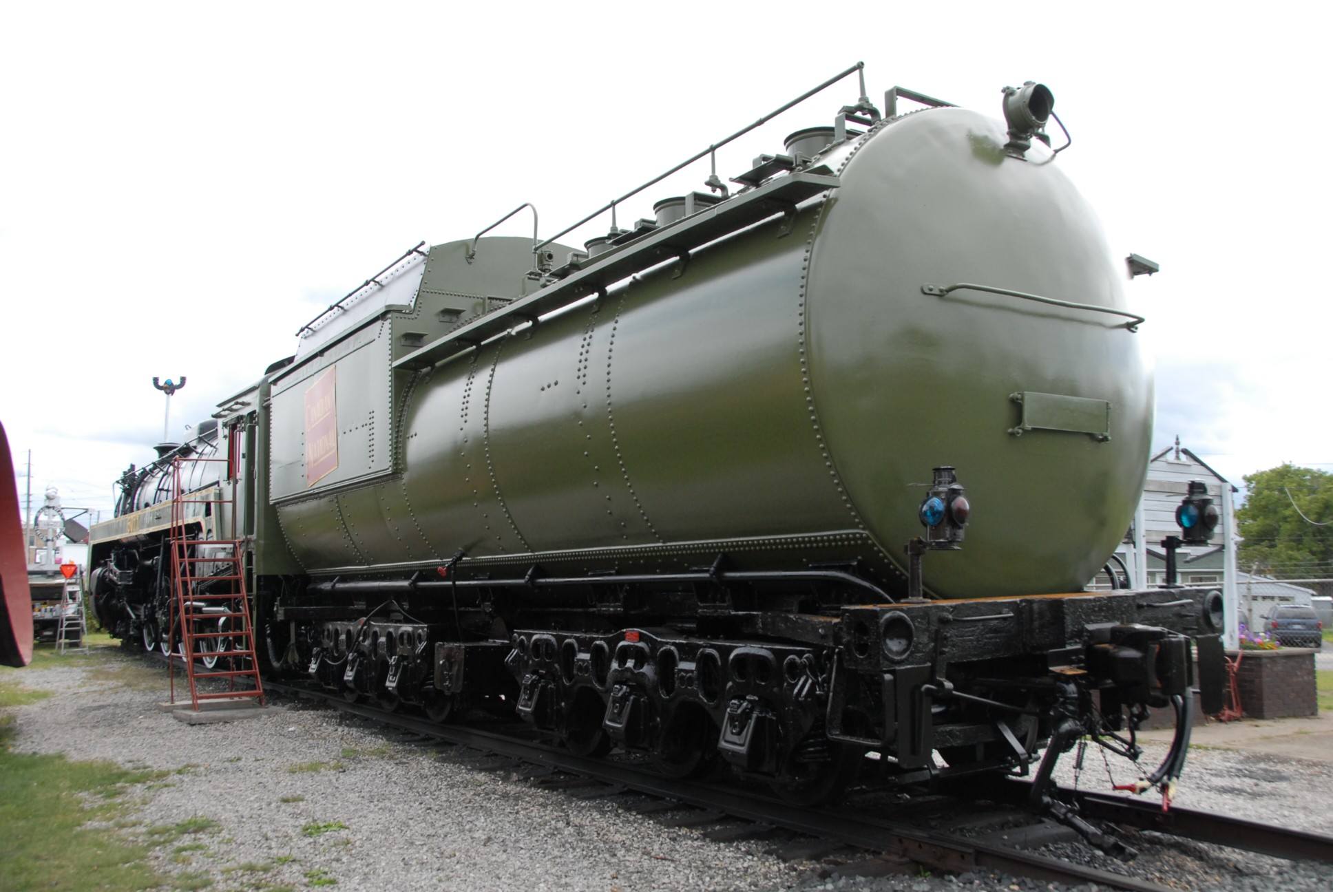

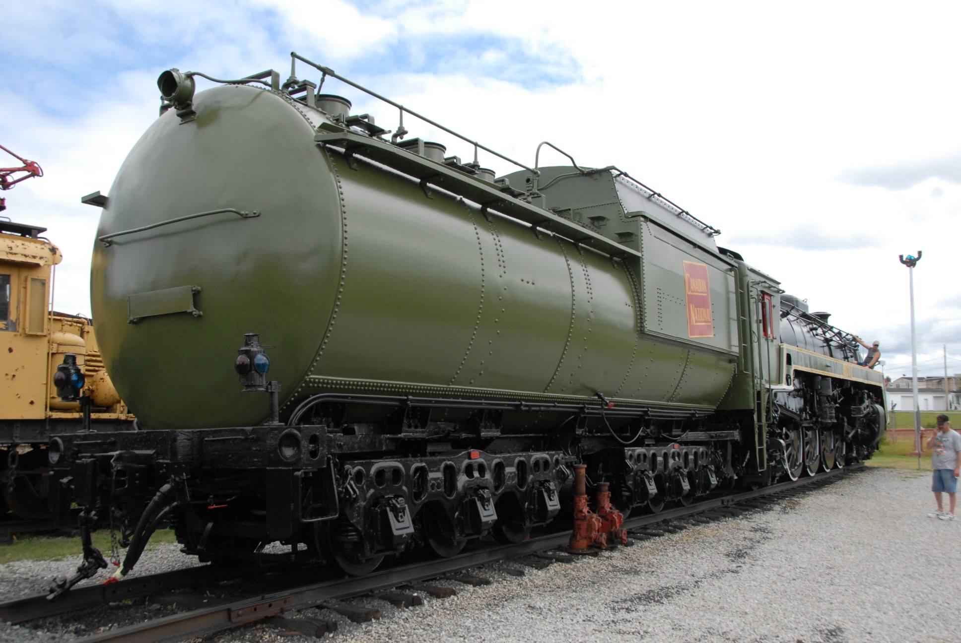

Some general views of the tender. The frame that the water tank and coal bunker sit on is evident. Compare these to the photos of 6069's tender.

Thanks Joe... could you make the pics any bigger though.. holy smokes!
