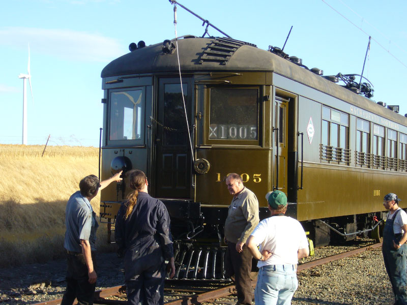

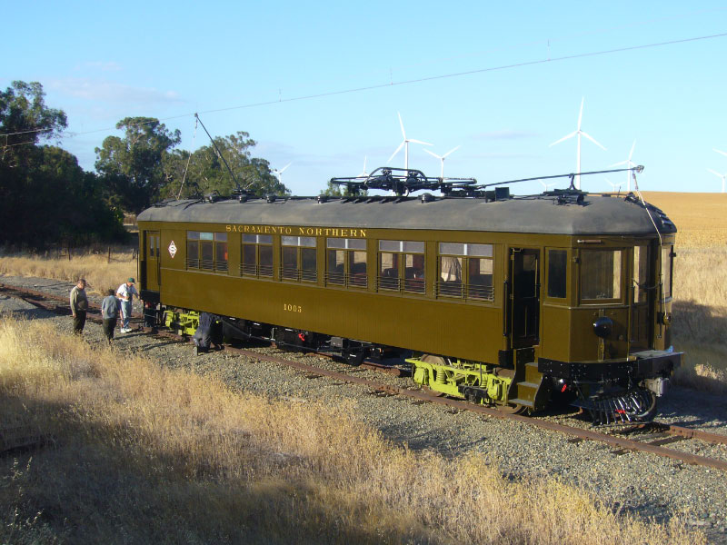

Yeserday the shop crew at the Western Railway Museum took 98-year old restored SN 1005 for a successful shakedown run in preparation for its grand unveiling in mid September. Here it is at Gum Grove on our Sacramento Northern main line, having the bearing temperatures checked and looking almost as it would have looked when running on the SN in 1934. (In 1934 there wouldn't have been any windmills and Dave Johnston, the shop superintendent, would have been wearing a suit.)

The green may look like pea soup, but it is historically accurate.
Would that we could run from San Francisco to Chico. Alas, our museum's track (one should consider it our largest artifact) is most of what is left of the Sacramento Northern.

I was in the car on Saturday and she is really looking wonderful. I was in the car the last time she ran; with a generator being towed behind her. This was soon after the WRM had purchased the 22 miles of SN rails. Yes, it does have track on it! It was the track that the museum purchased; the UP donated the right of way.
Anyway, the car had a ton of peach color paint on the inside the seats were a mess and pieces were falling off all the time she was running on the track. I think the event was to celebrate an anniversary of the Oakland, Antiock & Eastern.
I expect to see the car coupled to the O,A & E 1020 trailer in the near future. We have between 5 and 6 miles of wire up in the air. And there are more poles in the ground too. The current project is to get a sub-station for the line Remember that it was run with 1500 volts rather than the 600 that the museum is now using.
There is another SN project going this summer. The body of SN #602 freight motor is getting a cosmetic make over this summer. The car was built by w. L. Holeman at San Francisco in 1912 for the OA&E. The reason the Bay Area Electric Railroad Association acquired the car for the new museum at Rio vista is that it still has the Baldwin interurban trucks with the silly green paint on them.
After the end of passenger service the #602 became a MOW car with added doors and windows, Those will go away and the new primer paint already looks better than the faded freight car red that is on the car.

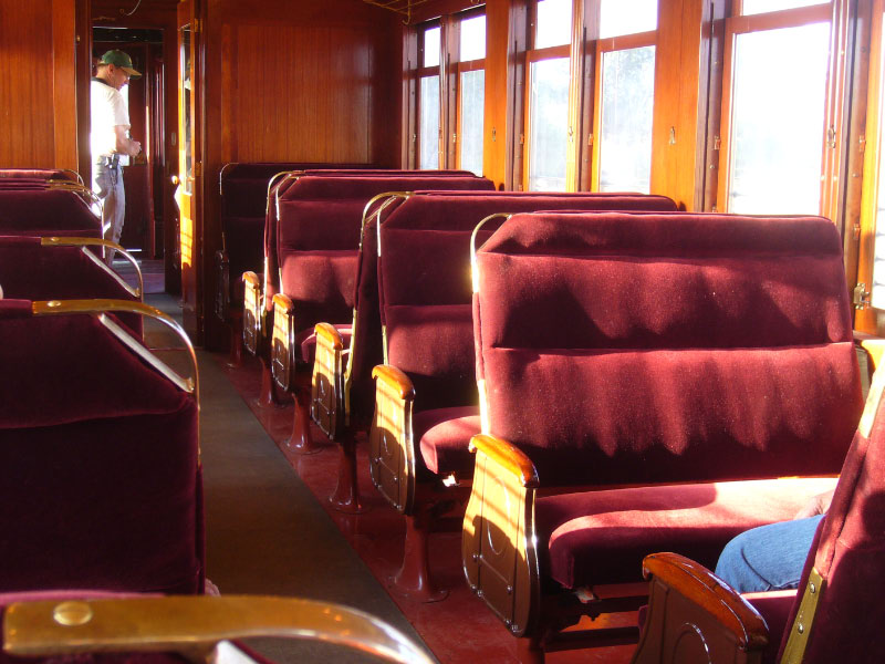

The old interior peach color in SN 1005 was authentic SP coach paint. Before the car was acqired by BAERA much of the interior mahogany paneling had been removed. Money was not available to replace the mahogany so available wood was used and then the interior was painted.
Part of the restoration involved replacing the missing mahogany wood, then staining and varnishing it like the original. Removing paint from the remaining mahogany was a lot of work.
Key System had removed the toilet compartment and replaced it with a seat. A toilet was not needed on runs between Berkekly and San Francisco. So a new toilet compartment with a water cooler had to be built and installed. Key even installed seats in the baggage compartment. Key needed to maximize seating capacity. Key owned the car after SN ended passenger service.
Holman Car Company that built the car was in San Francisco. Eastern car builders would have used oak or ash for the car frame. Holman used Douglas fir. An eastern builder would have used poplar for car sheathing. Holman used redwood.
Used lumber was purchased for the restoration and cut to size. These were old growth trees that were several hundred years old when they were harvested over one hundred years ago. This gave a wood quality that cannot be purchased today at any price.
Today SN 1005 is probably in better condition than the day it rolled out of the Holman shop in 1913.
Official dedication of SN 1005 will be September 18. Come to the Western Railway Museum for a public ride on the car.

What can you tell us about the seats? Original style? What was used on them?

The seats are of the original type if not the original seats. They are Hale and Kilburn modle 199-EE high back walkover seats. The upholstery is red plush. The steel frames were generally in good condition. They were sandblasted and painted. The arm rests are mahogany and were refinihsed. The seat backs required new brass seat handles, side and top hardwood frame members, webbing, padding, and upholstery. The cushions required new hardwood frames, all new flat springs, 50% new coil springs, new webbing, padding, and upholstery. The fabric is 100% wool mohair in the color Bordeaux 61481 which was purchased from Arc-Con Fabrics.
