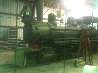

December, 2005 Dry Gulch U.S.A. purchased the 1912 Baldwin 2-6-2 steam engine. January 2006 restoration of the steam engine started to make it fully operational and preserved as it was new and first put in operations in 1912.
The 1912 Baldwin (No. 4) new started it's operations on the Klondike Mines Railway in Alaska. Following years of operations in Alaska it was purchase and made stops in two or three locations in the lower United States until purchased and stored in a field north of El Reno, Oklahoma. In Oklahoma the purchaser had plans for making it part of an active camp and recreational facility that never was completed. The information related to Dry Gulch prior to purchase was that the Baldwin had set on rails in a field exposed to the atmosphere for over 20 years.
On arrival at Dry Gulch all attachments, operations equipment, insulation, the shroud, what remained of the cab, etc. for the engine and tender were removed. The interior of the boiler and piping were thorough flushed. Rusted bolts and plugs were removed.
Following the above work the boiler, frame, domes, and other permanent parts of the engine were abrasive, blasted, thoroughly NDT tested and a high temperature inorganic zinc primer applied.

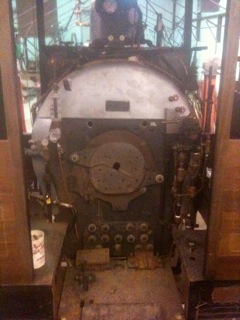

All boiler tubes were replaced, tapped threads where needed, all piping replaced with schedule 80 steel piping. T valve rebuilt, new piston rings installed, and a large group of driver joint swivels, bearings, shims, etc., made of brass and fabricated in a machine shop in Tulsa were installed.

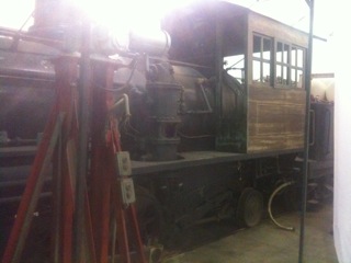

The cab is approximately 75% complete. The cab was made of Honduras Mahogany to duplicate the cab when new.
The Baldwin has been fired and brought to full pressure (162lbs) at least three (3) times and moved in and out of the barn on the spur tracks. The engine has not been tested on the main line track. There were steam leaks that require tightening but basically the engine performed as expected. Nothing has been done with the timing adjustments.
The engine comes with a 11” compressor that has been tested in service. No mechanical or hydrostatic oilers have been installed. There are two (2) 165lb. Certified pop offs on top of the steam dome.
Attached pictures show the engine from the time we first saw it until just prior to the cab being installed.
Dry Gulch U.S.A. has three (3) active steam locomotives. The Baldwin is considered excess to our needs and completing the rebuilding and using it is not our the best interest.
Through the inspection and rebuilding process care as been taken to make the Baldwin a sound and safe engine to look and operate as close as possible as to when it was new. Only quality and code required parts were used. Any part that was unavailable was made in a Tulsa machine shop.
