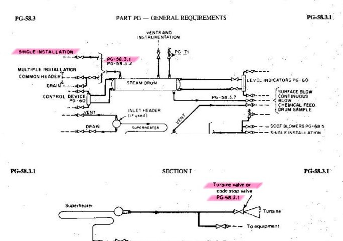

Boiler External Piping and Boiler Proper Connections
PG-58
PG-58.3.1 The steam piping connected to the boiler drum or the superheater outlet header shall extend up to and including the first stop valve in each connection, (except as required by PG-58.3.2. Not applicable) In the case of a single boiler and prime mover installation, the stop valve required herein may be omitted provided the prime mover throttle valve is equipped with an indicator to show whether the valve is open or closed and is designed to withstand the required hydrostatic pressure test of the boiler.
1. A locomotive is a single boiler and prime mover installation.
2. In a dome throttle installation the throttle lever indicates open or closed.
3. In a front end throttle installation the throttle lever indicates open or closed.
4. In a dome throttle, the throttle valve and dry pipe must be designed to withstand the required hydrostatic pressure test of the boiler.
5. In a front end throttle installation, the throttle valve must be designed to withstand the required hydrostatic pressure test of the boiler.

ASME BPV Code, Section I, paragraph PG-58.3.1 addresses the use of a throttle valve without the application of a stop valve within the ASME Code jurisdictional limits for piping. The preceding paragraph, PG-58.3 directs the designer or manufacturer to ASME B31.1, "Power Piping" for the requirements of the components used in boiler external piping, "The following defines the Code Jurisdictional Limits of the boiler external piping systems, including general requirements, valves, and inspection. The limits are also shown in Figs. PG-58.3.1, PG-58.3.2, and PG-58.3.3. The materials, Design, fabrication, installation, and testing shall be in accordance with ASME B31.1, 'Power Piping'."
ASME Section I, 2007 edition, 2009 addenda references ASME B31.1, 2007 edition. Paragraph 107.1(B) reads, "Valves not complying with (A) above [valves meeting the requirements of the standards and specifications listed in Table 126.1, i.e. B16.34, 'Valves'] shall be of a design, or equal to the design, which the manufacturer recommends for the service as stipulated in paragraph 102.2.2."
The bottom line is the Code does not limit the use of a locomotive style poppet valve (or any other style of valve) as a throttle. This does not relieve the manufacturer of the responsibility to design and construct the valve to the applicable requirements of the Code considering pressure, temperature, materials and other factors the manufacturer and owner deem relevant.
