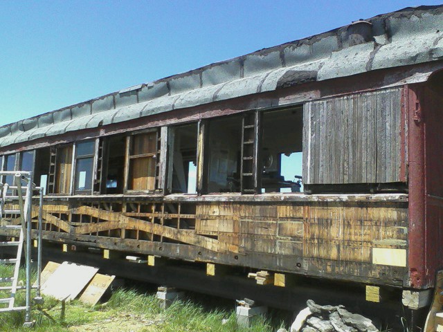

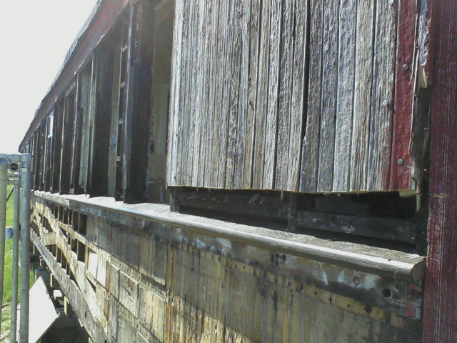

Today after work we ripped into the south side of the car doing the two man jobs that i had been waiting to get on with. we sliced thruogh all the top siding to remove the old window sill (original sill) and fitted two thirds of the car length with new sill, opened up all the remaining windows and found another old window, the top of this window is original cherry from new the bottom window another oak one from C&S 529.
The sills should be completed by mid next week.
Watch this space for some (hopefully) huge news next week !!
