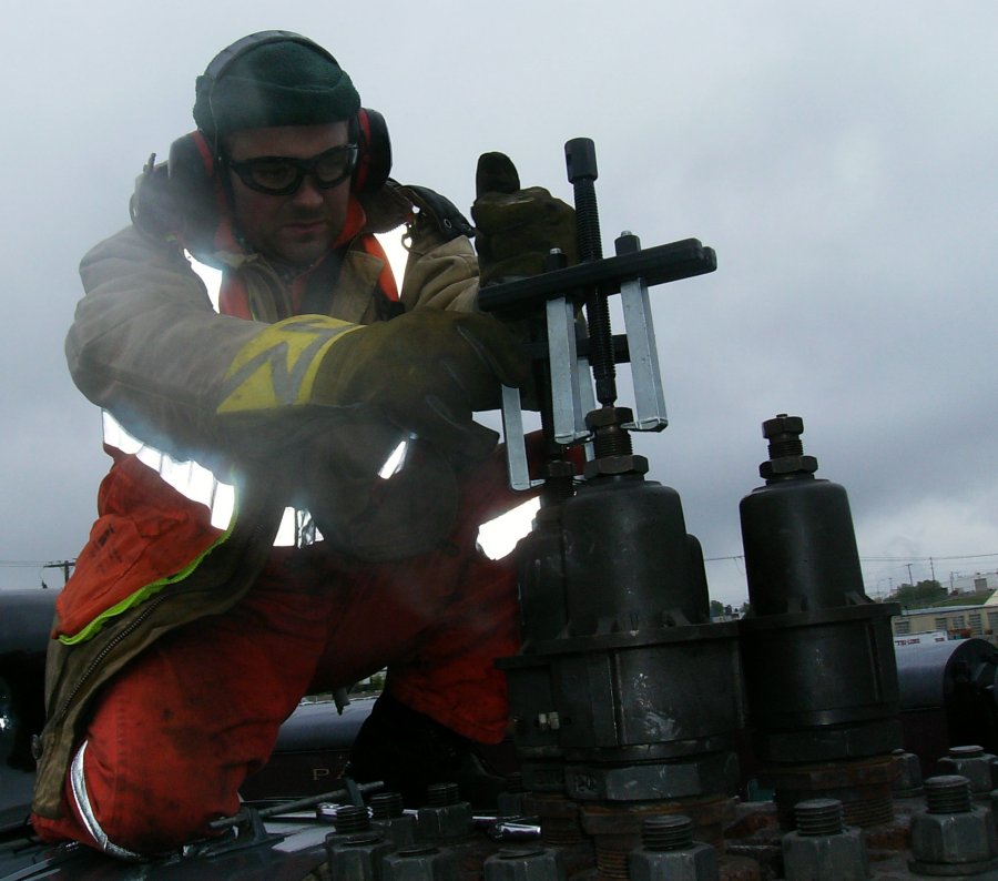

1. Jonathan Morris, Manager of CPR Steam Operations sets safeties that same afternoon.

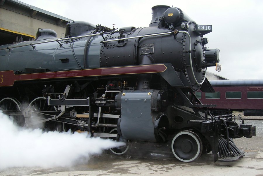

2. Canadian Pacific Railway Hudson #2816 rolls for the first time under steam in 20 months on May 28, 2010.

Nice photos of JJ setting the safety valves. For those not in the know the devices being attached "gag" the two lower valves so that the upper limit valve can be set. Once that one is set the next valve, pressure wise, is set by removing the gag and then the last valve, the lower pressure valve. The gags being used are industry standard.
The 3751 has Coale safety valves and these will not accept a Gag. The coale valve then have be cranked down to keep the lower safety from releasing during setting of the upper pressure valve. This takes longer than using a gag.
We have to sit on top of the boiler as well because the safeties can not be reached from the running board.
