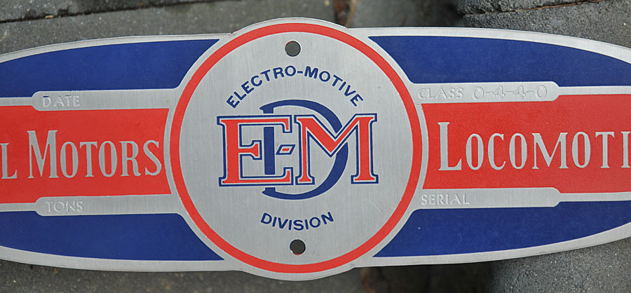

Scott - this is metal etching and by doing an internet search you will find several companies that can do this in a variety of material. You will need to provide the artwork done in a vector drawing program such as Adobe Illustrator.
Several years ago I had a company in eastern PA etch replica EMD builders plate out of SS just like the real ones. See photo.
R. Jahn
File comment: Etched Stainless plate hand painted after etching
