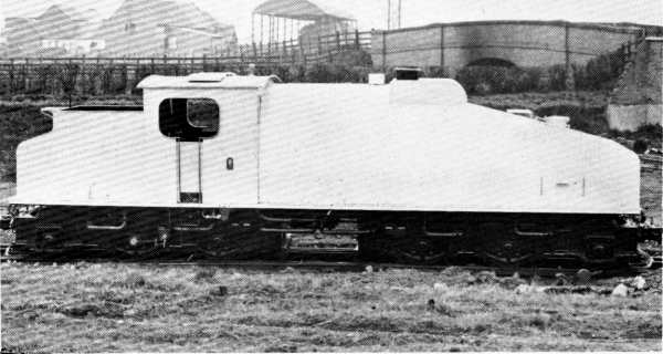

An idea that might have some merit....
Here in Eastern Oregon where commercial logging has been severely curtailed, a lot of the slash from Forest Service thinning contracts is being chipped on-site, sun-dried and shipped to a wood-fired co-generation plant. I don't know what kind of steam generating system they're using, or the thermal effeciency of the fuel, but apparently they've found a way to produce competitively-priced electricity.
Now...couple this renewable fuel source with an old idea from eighty years ago when British company Sentinel Waggon Works built several unique locomotives for South American service. These units used a high-pressure (550+psi) water-tube boiler coupled to truck-mounted steam traction motors. With this system they avoided both the balance & weight problems of ordinary reciprocating steam locomotives, and the inherently inefficient system of a diesel with a combustion engine coupled to a generater coupled to electric motors.
For M-U operation, current technology would allow for electronic fire control, while throttle adjustment could be handled with either an electro-hydraulic spool or an electrical solenoid, with safety cutouts on each.
File comment: photo courtesy of:http://www.dself.dsl.pipex.com/museum/LOCOLOCO/colombia/colombia.htm
