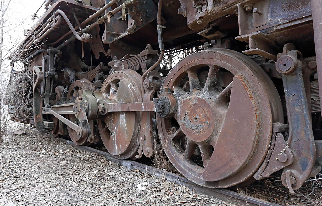

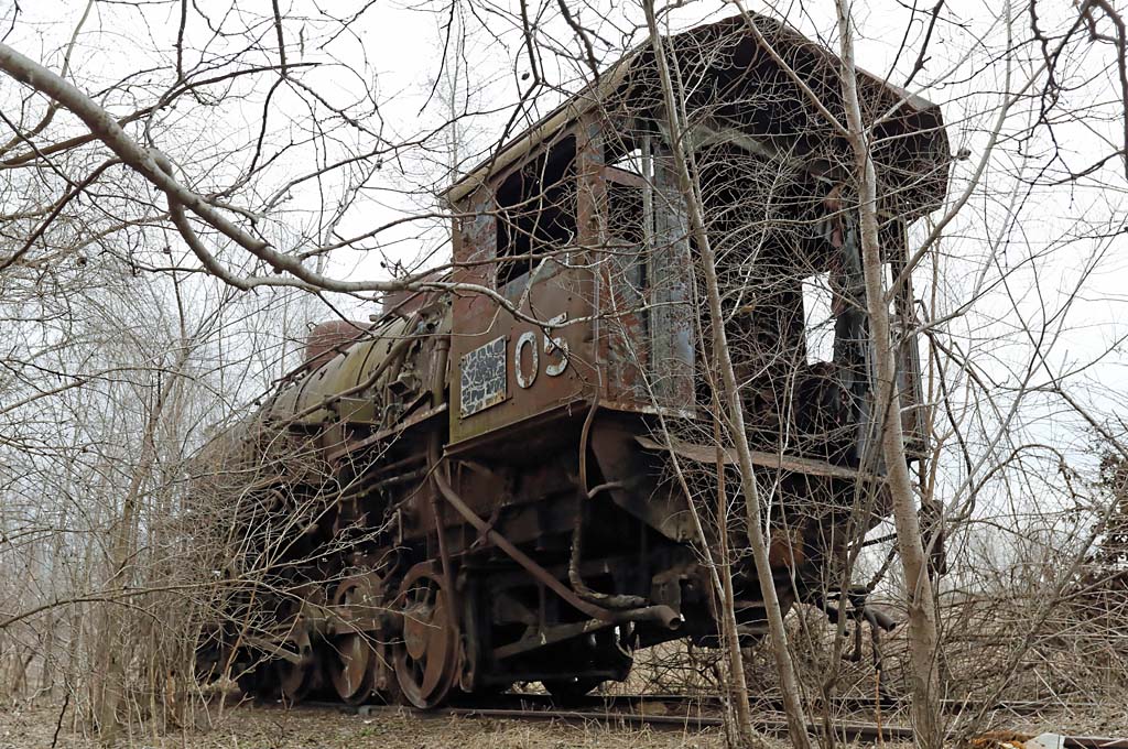

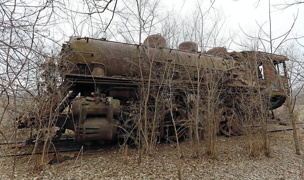

Only took four years to answer your question! I stopped by Galt yesterday. The 05 is still there (without tender), and is the only piece of equipment left on the property. Photos to follow.

First three...

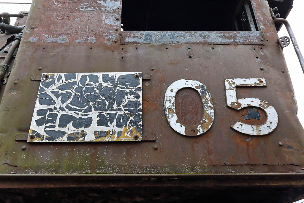

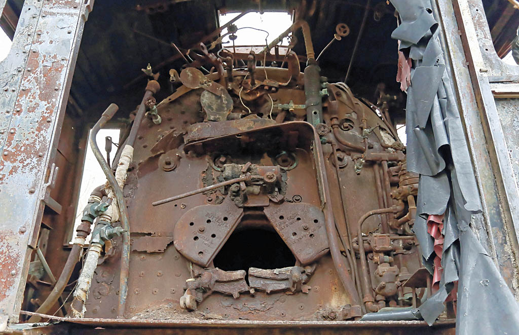

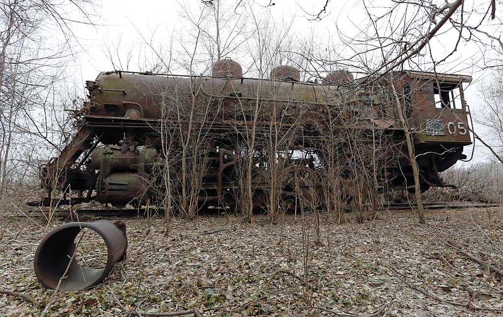

Three more....
