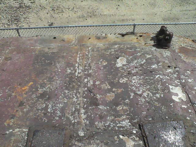

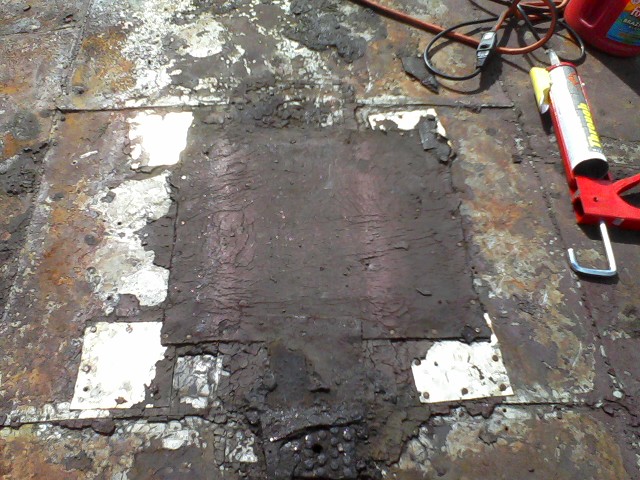

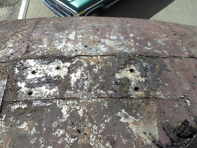

We were busy smoothing off and cleaning up the roof panels on the car today, sealing them with a really good brushable silicone ready for painting. What was plainly visible were the mounting bolt holes for ladders and holes for the roof walks installed in the bunk car conversion of 1926. I have attached some photos showing these positions, it would be great to see an artists rendition of how the car looked in its latter days.
Mike
Cheyenne
File comment: The patch covering the lamp chimneys and patches over the four lamp leg mountings
File comment: position of the roof walk mounting bolts
File comment: The bolt holes for the side mounted ladders, and in the foreground the roofwalk supports

Depending on how the car was equipped, you may also find mounting and vent holes for hanging lamps and Pintsch gas equipment roof mounted.
dave
