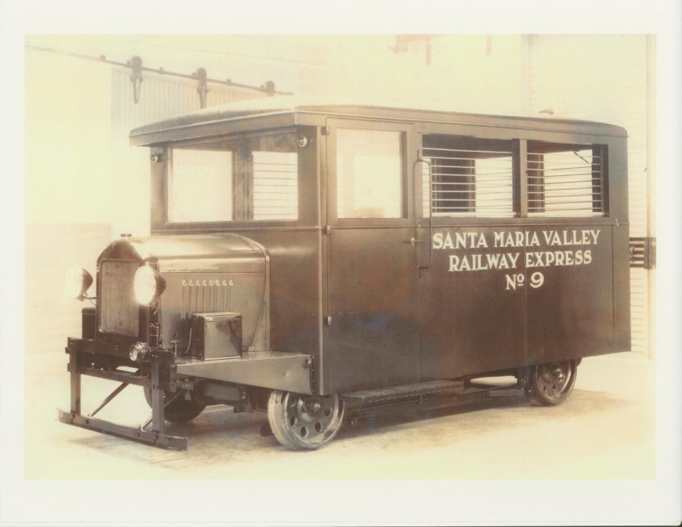

The Pacific Southwest Railway Museum has the Santa Maria Valley Railroad #9 on display at the San Diego County Fair this month in Del mar, CA. The visitors keep asking how many of these type of cars were built, and how many survive.
Does anyone know?
File comment: As built in 1932.

Yours looks to be either a model 2100 or a 2300. As far as I know quantities of the inspection vehicles/railbuses are unknown.
Keep in mind Fairmont sold the earlier versions like many heavy truck builders did, the factory sold you a running chassis, with hood & cowl, and the owner was responsible to build the car body.

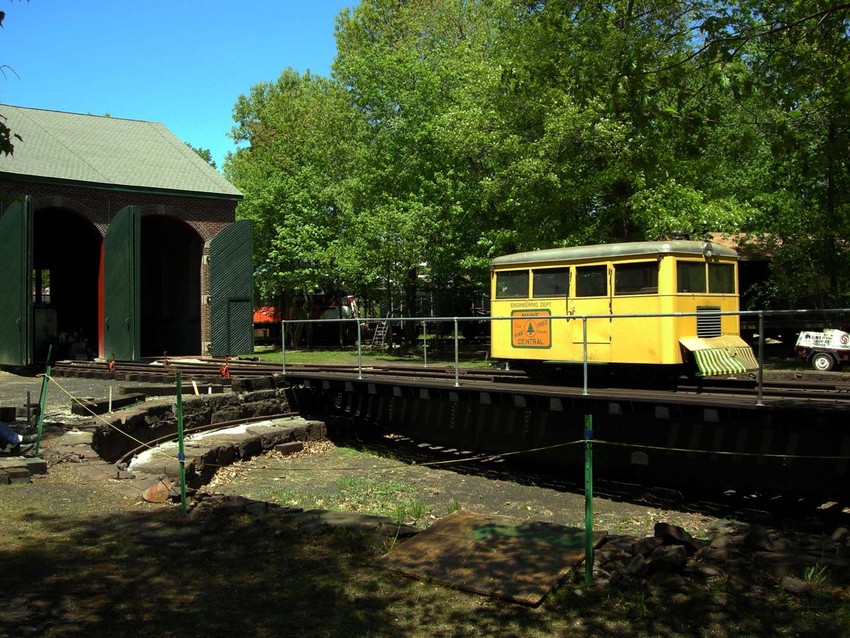

As for survivors, I think I saw one similar to yours up for sale, military surplus about 2-3 years ago. It was located at the Crane Indiana Navy Base. Of the later 3100 series, there are at least 2 still around. Ours, MEC 10/100 at the Connecticut Eastern RR Museum in Willimantic, Ct and the B&M 500 at Seashore Trolley Museum, in Kenneybunkport, Maine.
MEC 10/100
B&M 500

Only two Fairmonts show up in Edmund Keilty's "The Short Line Doodlebug" (Interurban Press 1988): yours (listed as a Fairmont Ford, which I presume means it combined a Fairmont body with a 1932 Ford Model A engine/drive), and a 1937-built Fairmont gas-mechanical 33.5' 6-wheeled baggage/12 passenger car built for the Washington, Idaho & Montana Ry., which is listed as retired in 1955. I will have to hit the other two books in this series at the Md. Rail Heritage Library tomorrow, but I sincerely doubt I'm going to find much more than these two.

.. yours (listed as a Fairmount Ford, which I presume means it combined a Fairmount body with a 1932 Ford Model A engine/drive),....
Indeed, that is correct about ours. The earlier post talked about a former military one and a photo of something which looks similar.

Thanks. I'm a speeder guy, and I was actually wondering if there was another car builder in the game that I hadn't heard of. The early years of speeders were quite in flux, with a lot of builders coming and going ... there were people in the railbus business who weren't in the speeder business.
Fairmont did make some fully enclosed speeders, but they really had to be nudged hard by the railroads. Coachwork isn't their thing. As such, I suspect the Santa Maria Valley unit was somebody else's carbody.
The B&M unit might be a Fairmont original... but looking at it, I think precisely one thing: L-O-U-D. Fully enclosed speeders are miserable things. I'm sure that's part of why they switched to hy-rail. Let Ford do the coachwork, get a nice quiet sprung interior... with cupholders...

Our's is a tin over wood frame as well. Not well built. But, at 77 years old - looking OK.
