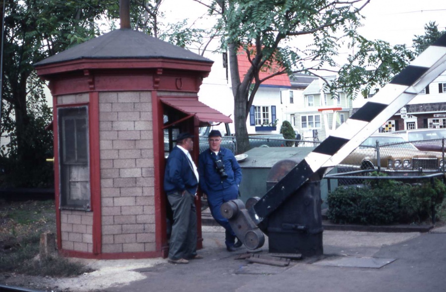

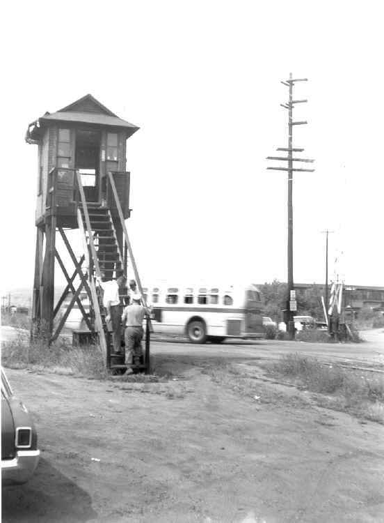

Hope these photographs might help. ( they were not taken by me ), however I believe they might prove helpful... One was taken on the NY&LB in South Amboy NJ... and the other at Ashley on the CNJ.. The black and white photo is at Ashley, and the color image is at South Amboy. ( I am not sure of the photographers so credit can unfortunately not be given )
Perhaps these old photographs can offer some ideas as to how to place that building ?
Dean Levin
