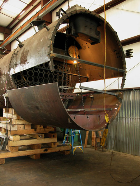

The smokebox has been welded to the old upper portion and the rivet holes for the circ seam and front ring are drilled. Next we need to make some 7/8" rivets and then drive them.
Robert Yuill
http://www.historicmachineryservices.com

Robert,
Thanks for the photo and additional info on 786's progress. Hope ya'll don't mind me paraphrasing what's been accoplished thus far. Just wanted to give everyone an update. People are starting to get excited here in Austin about having her back.
