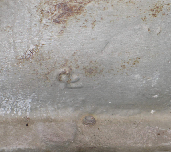

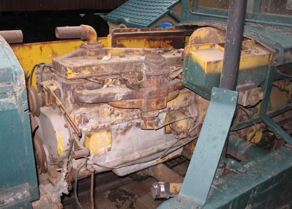

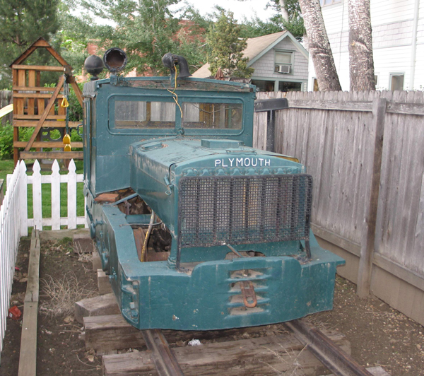

Thank you everyone for the information. As suggested, I have attached some photos of the locomotive and its engine, perhaps these will lead to an ID on the engine type.
Jason Midyette
File comment: Casting mark on the engine block
File comment: Overall view of the engine
File comment: Overall view of the locomotive

Recieved the following info via the "Railcritters" list. If the engine is the original, it is a Hercules. Also appears that Dupont was the original owner.
Jason, I have back channeled you some additional information that may be useful.
J
Being an FLH, it that locomotive has its original engine, then it ought be a Hercules (that's what the "H" in FLH stands for). If so, and in as poor a condition as it sounds, it might be toast - Hercules has been gone since the '50's and parts are scarce.
There is a shop that specializes in Plymouth, namely Plymouth Locomotive Service (contact them at: pls@plymouthlocomotiveservice.com) but if it is just a matter of rebuilding the engine and clutch, a more local shop might be more advisable. Actually, finding somebody that works on Hercules engines would be the better choice, if such a shop could be found.
With best regards,
Jay Reed
Plymouth #3784 was built new for DuPont at Louvires, CO. Plymouth used
standard components such as engines and clutches so anybody that does
truck work should be able to work on it if they can get the parts......... I forgot to mention that a very good source of information and help on
old engines and clutches is your local antique car or tractor club. The
machinery used in Plymouth locomotives was off the shelf technology for
the day.
John T.

I see some Hercules-like features, but some differ from the DOOC diesel I have.
If it's a Herc, look for the serial number engraved on the side of the block, near the front of the engine, just below the head gasket. I think ours is on the right hand side when facing the front of the engine.
If it is a Hercules, you can also use Oliver Tractor resources as some of those tractors/crawlers were powered by Hercules engines. Both ended up as part of White. Hercules actually survived into the early 80's but I understand that near 100% of 1960s-70s production was for military use. They were rugged but that priced them out of commerical use.
