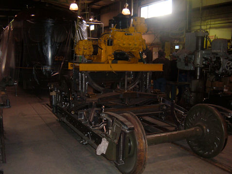

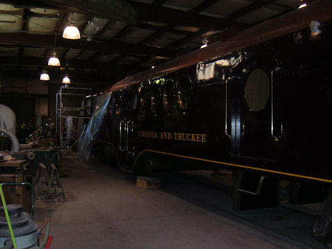

Here are a couple of views I took of the car back in mid-October, 2008. The roof was being painted at the time. The truck is a new fabrication to look like an original, except that instead of building a new McKeen gas engine a modern diesel with a hydraulic transmission is being used. Sorry for the darkness of the photos, but the car was inside the shop.

On behalf of the railroad restoration specialists at the Nevada State Railroad Museum in Carson City, thank you for the comments and encouragement regarding V&T McKeen Car restoration. The work, underway in fits and starts since 1996, is projected for completion by mid-2009 -- with a "hoped for" roll-out as part of the museum's annual July 4 Transportation Fair.
As the pictures show, most structural, interior and exterior restoration is complete. We are presently hanging air brake piping and building the control stand. The power truck is in final assembly and we expect to test run it within a few weeks. Assuming a successful test, we'll raise the car and roll the power truck under the body and begin final power assembly. The Museum has been fortunate in recent months as three original interior light fixtures and the whistle have been returned. (The light fixtures will allow us to pattern faithful reporductions and the plan is to reinstall the original whistle.)
The project has as is the case with most heroic efforts of this magnitude, taken longer and cost more than originally planned. All told, when complete, the State of Nevada will have invested just shy of $1.0 million on the project (the V&T paid $22,000 FOB Omaha for the car in 1910). Fortunately, adequate funding is now available to complete the work -- not a likely outcome were we to pursue the funding in the face of the current economic crisis.
As one writer noted, the car is being powered by a caterpillar diesel driving hydaulic pumps which will drive a double-chain drive to the forward axle -- balancing current technology and life-safety requirements with the original fabric -- tradeoffs necessary but allowing the car to maintain its National Register listing and eligibility.
At present it is planned that the car will operate on the grounds of the Nevada State Railroad Museum -- there are no plans at this time to operate it on the rebuilt V&T or other lines off museum property (the car is by current design quite underpowered and not likely to be able to exceed 20mph on level tangent track). We are in the initial stages of planning for a major event in 2010 -- to celebrate the centennial of this McKeen Car. A book, documenting the McKeen Car Company and the history of V&T #22 car is also in the works.

Having made many visit to the NSRM shops, most recently in Oct., the car is more impressive in person than in the photo... It is truly spectacular, well researched, and just plain pretty. The interior is wonderful, Cuban mahogany, orange ceiling with a interesting intricate striping pattern and a circular bench seat along the rear wall. They made their own patterns for spoked wheels and such for the power truck, for the port hole windows and are working on interior lamps.
The "Wisconsin or Minnesota" motor car provided parts for a rear truck and various body parts, but its power truck was long missing.
