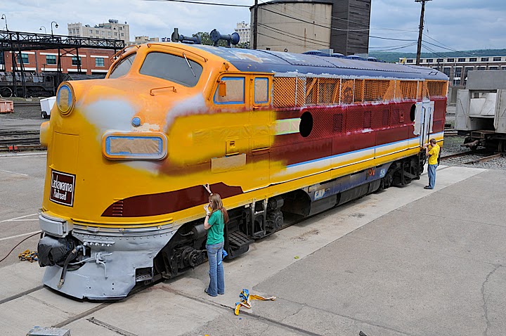

Both of the units are getting considerable attention to areas of the bodies that had extensive rust and corosion. After 60 plus years there are several well known points where significant rusting occurs. Various rust treatment coatings have been applied to both units and where needed old rusted sections were removed and new steel welded in place. Unlike in a railroad shop where the steel patch would simply be welded on top our patched have been welded in place and ground smooth so as not to change the original lines of the locomotive.
Compared to the CNJ paint, this DL&W freight scheme is very complicated - five colors (black, yellow, maroon, gray, white) and seven parrallel stripes the length of the unit!
All of this takes a lot of time in hours and days of volunteer labor. At the end of this both groups will have put in hundreds if not thousands of hours of labor of love. It is being tabulated by Steamtown as a matter of record.
Commercial automotive paint is now about $200 per gal with all the additives and about 12 gal is needed for one unit so the cost is significant and the donations are appreciated.
We are all looking forward to taking pride in displaying the finished product. #664 which is the ARHS unit has certainly garnered quite a bit of attention from Steamtown personell as well as the visiting public as she in or near the old back shop area.
Rich Jahn
ARHS project coordinator
File comment: Painting satus as of 5-24-10

It was really interesting to watch the work progress during the day 5/23.
In the morning, the unit shown looked like rainbow sherbet, by the afternoon, you could see the DL&W paint scheme emerging. It will be neat top see these units when complete-the crews were enthusiastic and safety conscious.

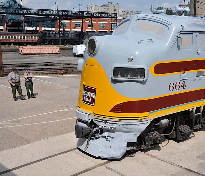

ARHS F3 #664 progress at of May 27 - painting of cab nearly complete.
Rich
File comment: "DL&W #664 in the sun for the first time as Steamtown rangers look on.

It sure does add life to Steamtown even though its a diesel.

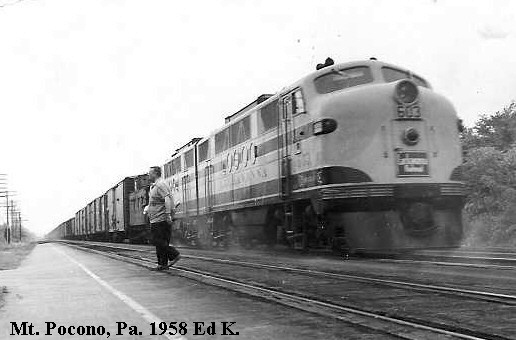

File comment: FT in same scheme
Ed K.
