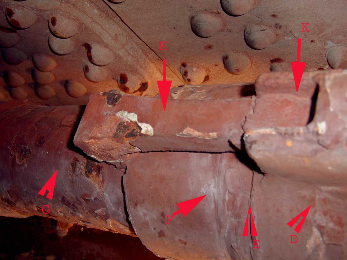

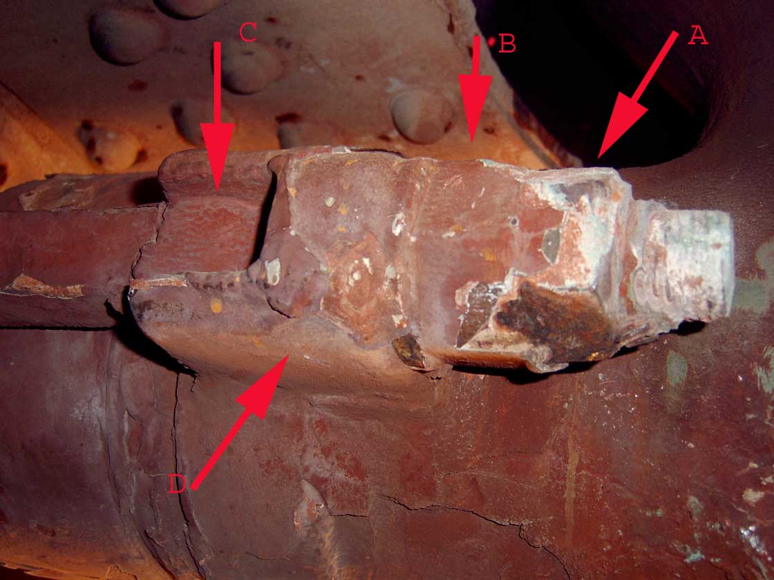

Here's a couple of pictures. I've gone over the area with a needle gun since these were taken, so the scale now isn't quite as bad. In one picture, A and B are nuts. I cut off A with a cutting wheel, and have been able to back off B several turns. D is the "ear" on the throttle body. The area from C back through the ear to where B is is so full of scale that I haven't been able to loosen the bolt.
In the other picture, D is the throttle body, E is the joint between the throttle and the dry pipe. According to the ALCO blueprint for this engine, there should be a ring with a hexagonal cross-section that actually forms the seal between the throttle and the dry pipe. F is a collar that is welded onto the dry pipe. G is the dry pipe. H is the j-bolt that hooks over the collar to hold the throttle to the dry pipe. And K is the same place as C in the first photo.
There are two of these bolts, in the same condition, located at 9 o'clock and 3 o'clock around the dry pipe.
Jim

I managed to cut off the outside nuts (A) with a small cutting wheel. They are 2" nuts, and there wasn't enough clearance to get a nut splitter between the nut and the throttle body. So, now the second nut, (B) is backed off several turns.
I can knock the scale off ok on the outside of everything. The problem is at (C). There is scale between the bolt (square in this area) and the "ears" (D) that the bolt has to slide through.
